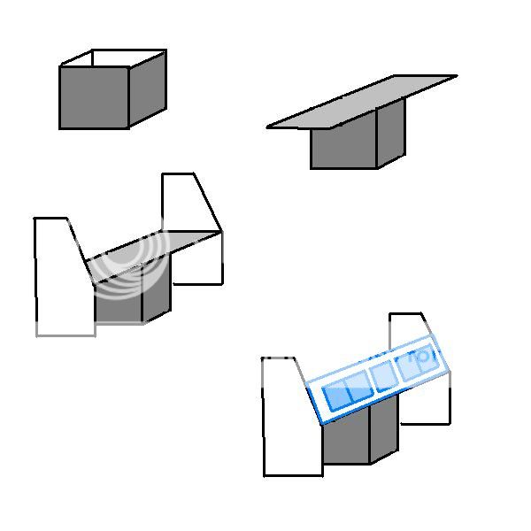

Just an idea but you may also consider building a Main Instrument Panel and a structure which will end up looking more closely like a Jet aircraft cockpit.
There are many ways to achieve that, here is one , fairly simple, made out of MDF or Plywood.
You can adjust the dimensions to your available space., knowing that a dual seater,  even a narrow one, looks always better and more realistic than a "half cockpit" (and allows friends to sit next to you)
Just remember that the main shelf must not be higher than 20" max so that you look DOWN at your instruments and STRAIGHT at your outside view.
Later you can also add a slanted top shelf to house the MCP/EFIS Glareshield

barettaj
Thanks Jack but unfortunately my space is 5 feet wide and 4 feet deep so a dual seater would be hard. Thanks for the dimensions thou i will be using that
