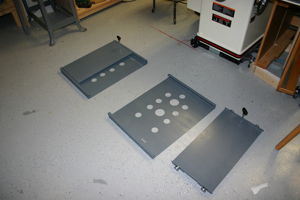

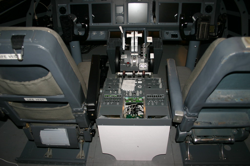

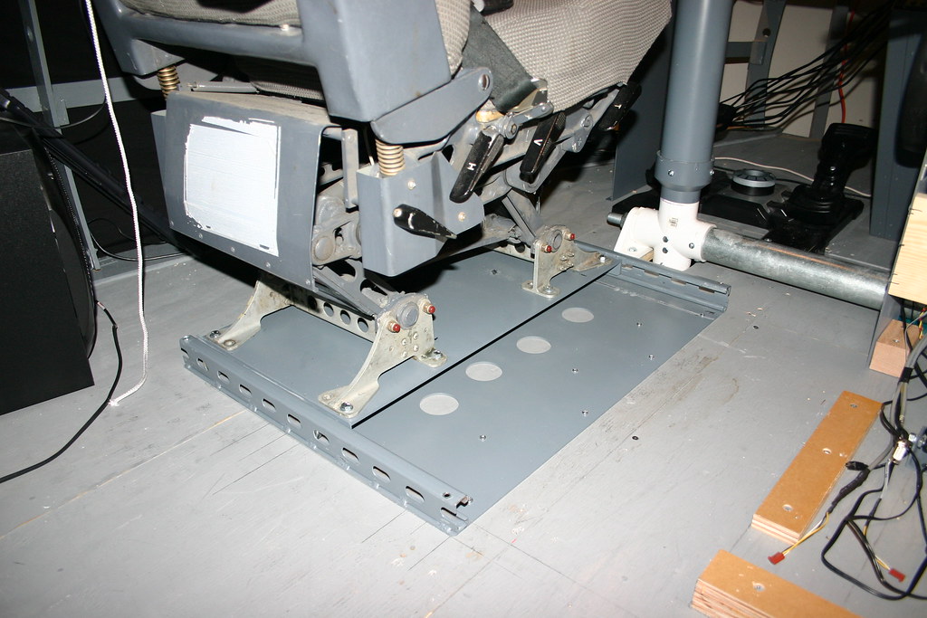

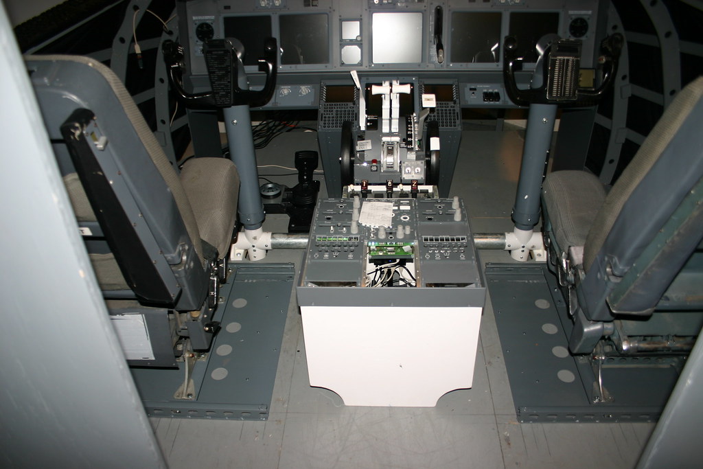

While I have been very busy this summer but finally managed to get a little more work done on the simulator and thanks to my good friend Tom on the west coast (aka. - Astron) I am now able to easily get in and out of the cockpit seats.   Tom made me some custom seat rails for the simulator for my weber seats to slide sideways away from the pedestal and allow room to get in and out.    I know this has been done before and there are a lot of options out there from various vendors but it is always nice to have each other to call on also and Tom with his waterjet and welding skills has really helped out with my project as well as helping a lot of others in the Learsim community as well.   Tom as you know has a full size FDS setup now also and made some rails for his also.  All I can say is they are perfect!   Here are some pics.

Weber seats have a forward and aft adjustment built into the seats. The seat is bolted to the floor and doesn't move. It was not necessary to have a sideways motion as these seats were used when the pedestal was only a two bay. IPECO seats were also used in the 737 when the pedestal was a two bay, so they too did not need to move side to side. They rode on straight rails and moved forward and aft on the rails. It was only when the pedestal went to a 3 bay was it necessary to have the seats move side to side. This is when J rails became necessary to move the seats for and aft as well as side to side. I am no expert on this subject, but this is my understanding based upon what I have discovered when I purchased my latest seats for my sim. I had Webers and built a platform much like Scott's that I built myself out of wood. I bought a pair of IPECO 737-300 seats that did not include straight rails. I am presently looking at two different suppliers that build a platform that works with IPECO and Weber seats that creates the same travel path as JRails. They are expensive, but give the look and space that I need to get in and out of my sim.
