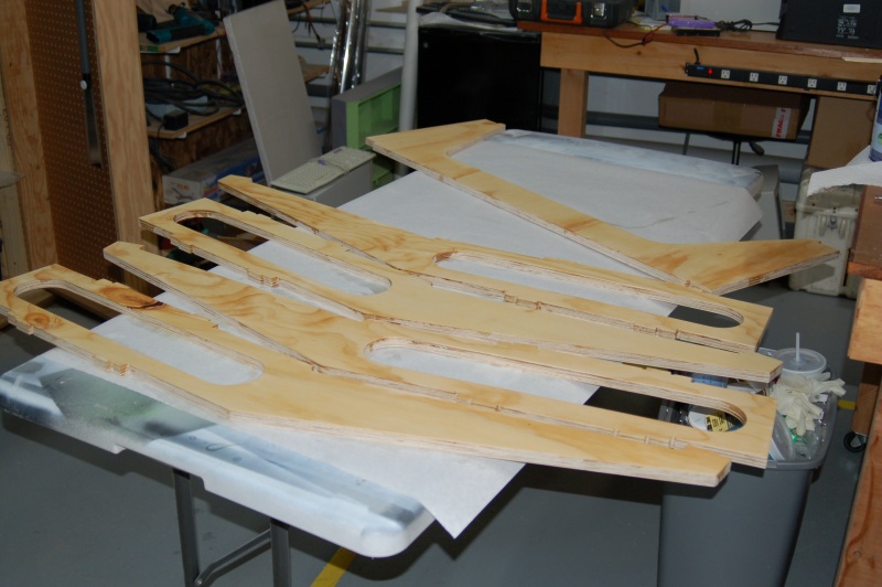

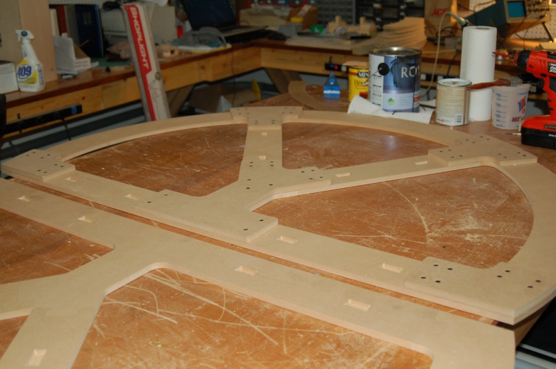

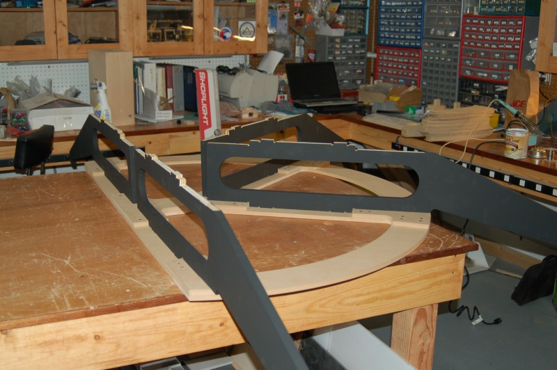

The "spider" arms for the screen & projector support platform were cut out last weekend.
Here's what they looked like right after getting sanded & painted with shellac sanding sealer:

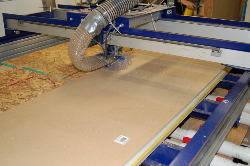

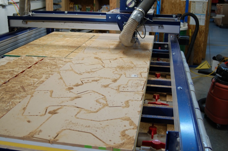

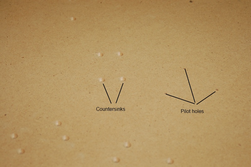

In order to strengthen the material joints in the screen support parts, we needed to cut a set of doublers.  Part of this was seeing if we could get the 'bot to do the countersinks for us.  I had a 3/8" 82 degree countersink that I could fit to the 1/4" collet on the 'bot.  Wayne created a file in VCarve that would have countersinks at various depths - turns out .210" is perfect for a #8 flat head screw:
Having the 'bot do all these is a LOT easier than me doing it with a microstop!
This is what the doubler parts looked like as they're being cut:
...and after being glued & screwed to the screen support panel:

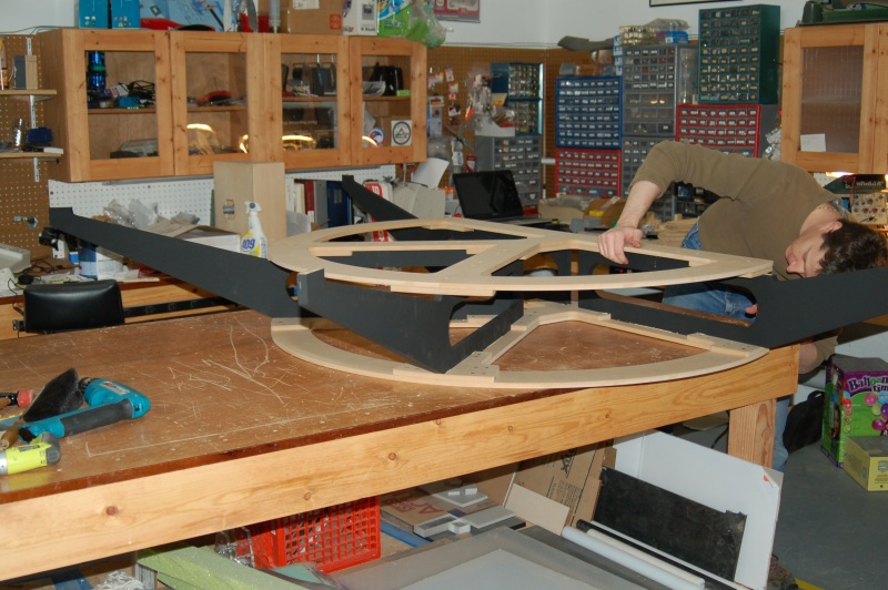

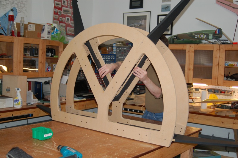

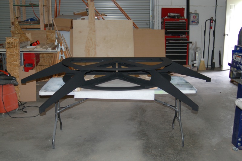

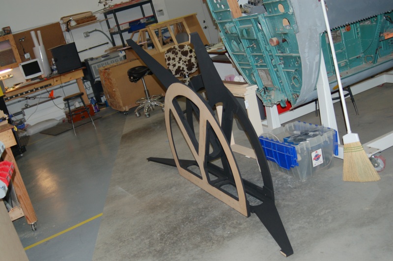

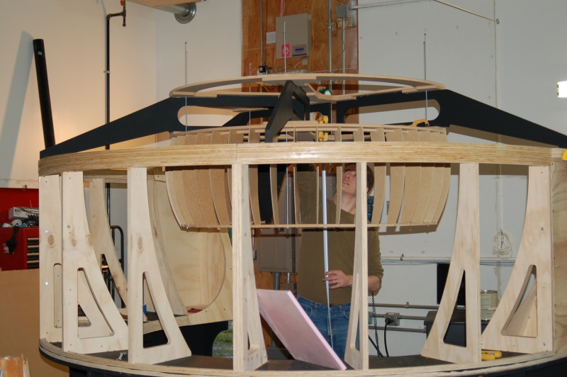

After getting those in, we added the "spider" legs - you can see from the picture why I call them that:
Here's a picture of what it looked like after we got the top layer added.
Like most spiders, this one doesn't like being on its back...

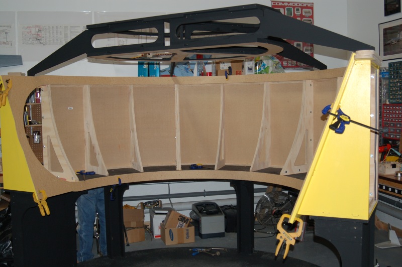

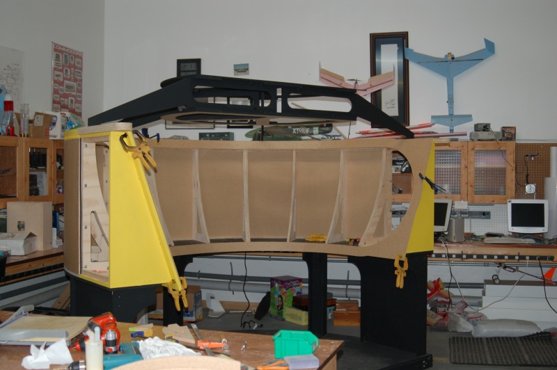

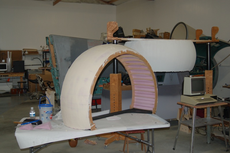

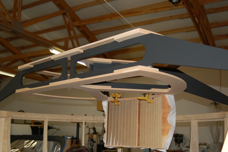

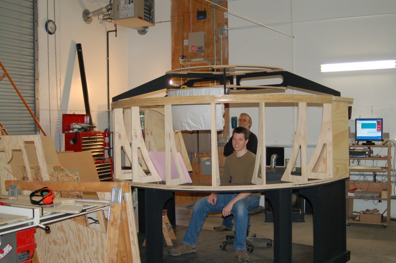

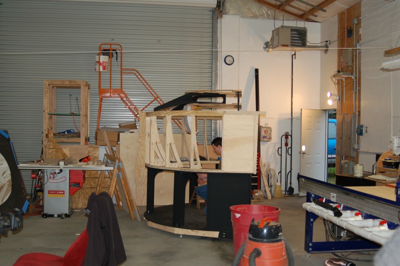

Here's a long shot with the screen support resting on the mirror framework.
Just for the heck of it, Wayne clamped in the first screen section we ever built - this is actually a small slice of the full size screen you saw being assembled in the time-lapse video.
I figure I'll hang on to that ratty old thing - who knows, the Smithsonian might want it some day. *laughs*
This picture is pretty amusing.  Wayne is all, "Hurr!  This is SO cool!", while my friend Rob is all, "Hrmm.  I do believe we CAN take over the world with this!" :D
Please note the pink foam screen analog. :D  It's about the right size for a 19" display.

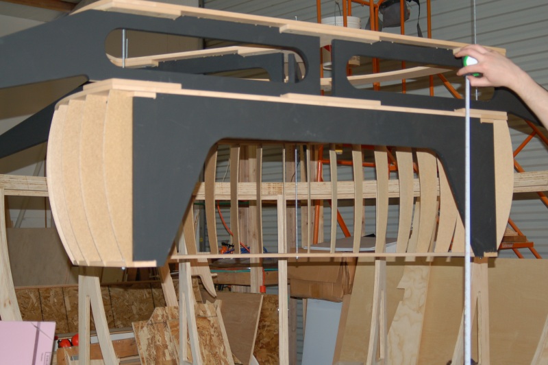

Here's a couple of shots with the screen installed:
I would have taken a wider angle shot, but I couldn't back up any further while it was in the location it was.  Stupid thing is so big you have to back WAY off to get it all in one frame!
During the week I'll be applying sealer to the screen frame components and the screen mounts so they can be painted.  With any luck we'll be able to get the foam inserts installed into the screen soon!

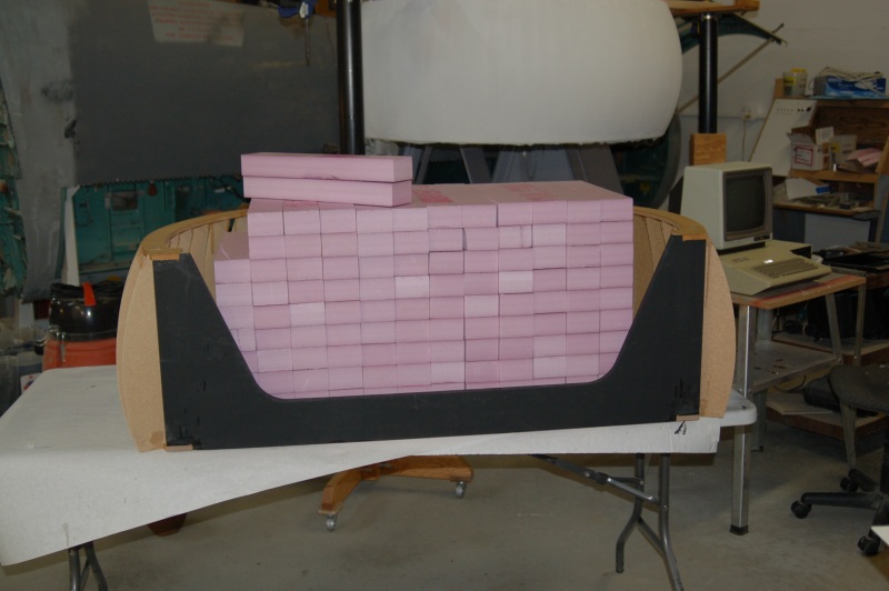

We got the foam blocks cut for the screen.  That stack of material used to be four 96" x 24" sheets.  Wayne built a slick jig that allowed them to be bevel cut without getting your fingers too close to the saw blade.
The blocks shown above were hot-wire cut in a special jig that used spare ribs from the screen in order to get the shape perfect.

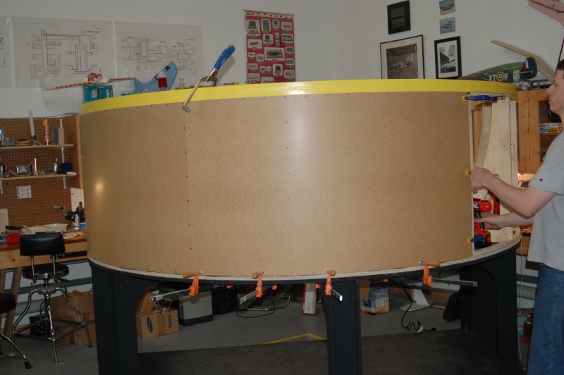

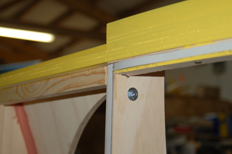

Each mirror segment and the backs are sealed with a 1/32" rubber gasket to minimize the amount of air leaks in the system.
Applying the framework back panels...
The colors for the frame will be yellow for the "ear" boxes and peripherial framework and blue for the back panels.  Gotta keep with the whole Simpits/Link Trainer colors you know. :)
We also test-fit the new goggle-mask.
It's quite likely that when the mask is attached "for real" to the framework, the mylar for the mirror will follow shortly behind.  Right now we figure we're only one or two work days from performing the first draw-down of the mirror.
The screen was assembled and the first layer of filling compound was applied.
Once the sand/fill cycle is done and the shape is correct, I've got some Behr screen paint we're going to try with it.
