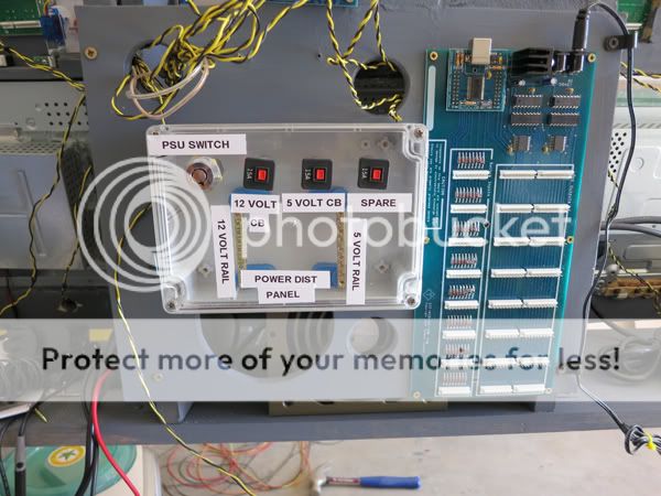

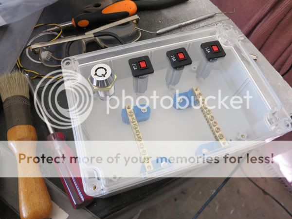

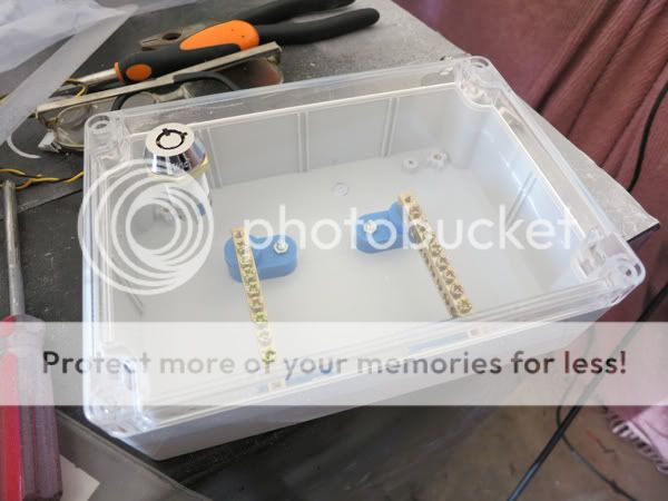

Seriously tho, I'm at the stage of wiring up my MIP, so after reading comments from here and talking to the guys at FDS, I knew I needed to slot in some fusible links to my 5 volt and 12 volt rails.

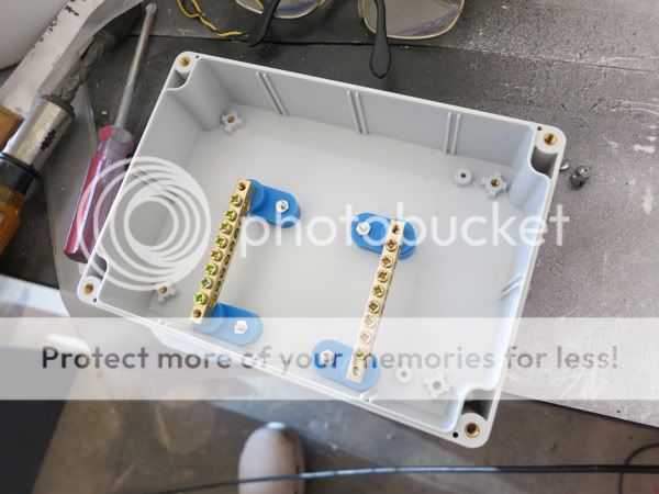

So, I bought a distribution box and mounted two rails (I blew it, I now find out I've left out the negative rail, so I'll be correcting that on Tuesday) and then instead of fusible links I bought circuit breakers, which were also mounted in the lid of the box.
I then added the keyed switch for my PSU and ran the wires back to the molex connector on the power supply (orange and black).
Here's some pics of the job:
The box with the mounted 12 volt and 5 volt terminal blocks
Then I added the PSU keyed switch
And lastly, I added 3 circuit breakers. One for the 5 volt rail, one for the 12 volt rail and a spare

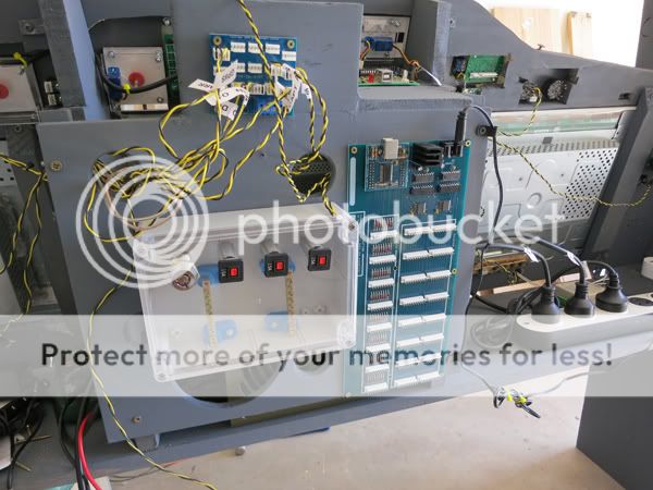

Here's how it looks mounted to the back of the MIP
And finally, I attached a legend

That looks great Frank.  Good for you for adding the breakers, many of us don;t do that and pay the price later.

Whoops...forgot to add a negative terminal block in the box, so I moved the other two over and will fit an extra block tomorrow, when the shops are open again.
I also meant (in the pics) that i'd be hooking the green wire and earth up, to the keyed switch. I especially like the idea of being able to turn the PSU on and off via this easy method.
