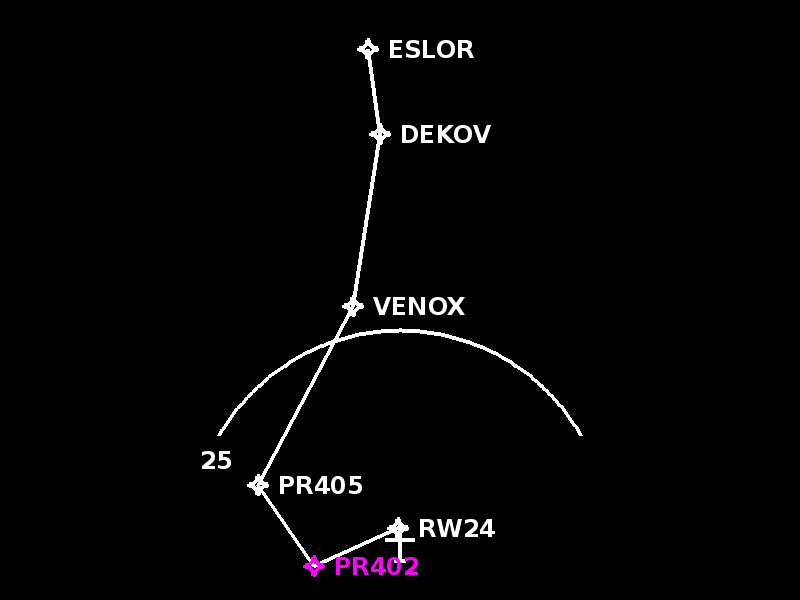

I am coding HT1000 GNSS used in regional turboprops as ATR -500 are. GNSS is standalone SW running outside FS, connected via standard IOCP (SIOC server). Right now I am able to produce EHSI RNV MAP image - check this: http://atrproject.wordpress.com/2012/02/04/gnss-ht1000-is-moving-forward/
I am currently looking for beta testers AND for someone, who will be able to inherit my RNV MAP into Gauge Composer built EHSI gauge.

Ok, here is update on HT1000 GNSS FMC development.
HT1000 GNSS functions preview
Currently there are two important issues I work on:
    How to follow LNAV track (i.e. guiding AP to intercept and follow constructed track)
    How to construct VNAV descent path.
For LNAV navigation I am currently playing with FSX autopilot commanding it in HDG mode, to follow LNAV track. I am also working on track intercepting logic. Regarding the VNAV I analyze possibility to use Dijkstra graph method to construct descent path.
When I will finish these two challenging issues, there will be first beta release. Meanwhile in the time I am too tired by trigonometry functions, ;D I am checking page by page, function by function functionality of GNSS against Honeywell manual and videos made in real ATR and certified FTDH simulator. I am still finding some minor discrepancies, but most of them are just cosmetic issues. :-)
