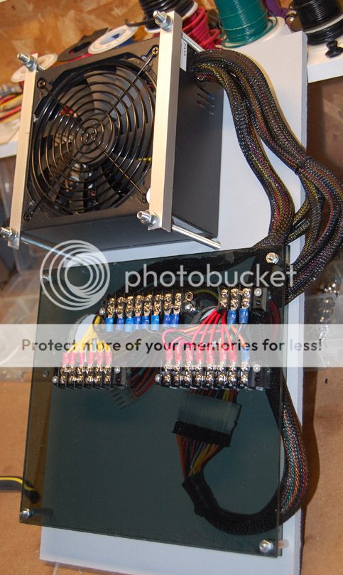

Planning to install terminal blocks /fuses/ PSU for OVH and relay board. (5V & 12V).
Thsi will be located on the  outside of the backwall.
What would be the best choice of material to install the above items on?
Wood not being an option !
Any suggestions? :D

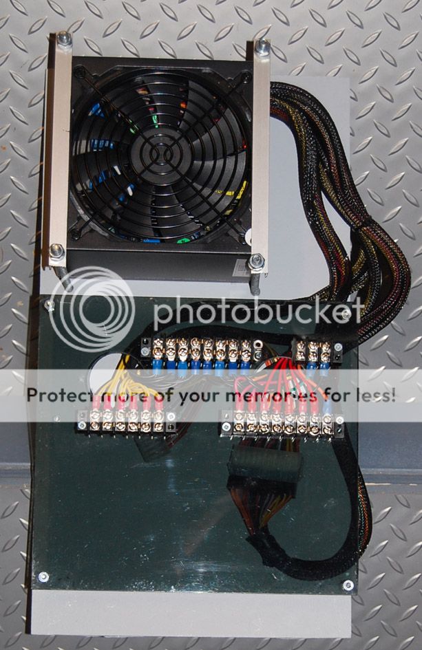

Here it is:
yellow 12V/ red 5V /one orange 3,4V/ black ground.
Plus one terminal for the green and black (battery switch)
The PSU is an ample 1200W.
Each bar has jumpers so it acts like one bus.

Just as a reference if you are stuck one day with a PSU.
PSUs have sometimes different operating requirements
For this one:
For 5V to work, there must be a load on the 12V bus
A strip of leads is enough ! and the PSU has to be started with the trigger (Green wire) not the back switch..
