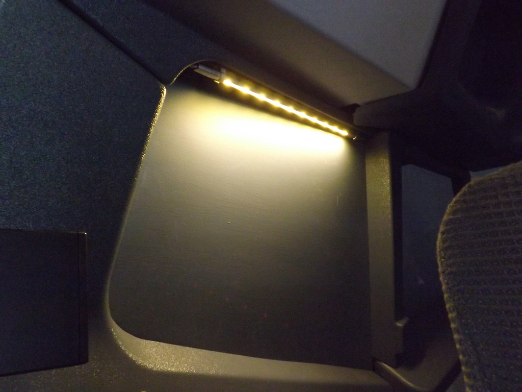

Been in the sunshine for a few years :)  I couldn't do without it now.. makes such a difference to immersion.
Super bright leds in a U-shaped channel, which prevents light spill and means it can be directed inside accurately.
Hooked to the sim above the top window line with flexible metal (builders strapping) so its strong but can be easily twisted, bent, moved to get the lights just where you want them but well outa eyesight.
Programmed via a relay card in SIOC to switch on during the day, off at night.
Just haven't got round to programming the sun direction yet  :o
Will you guys put up some pics of your lights please?

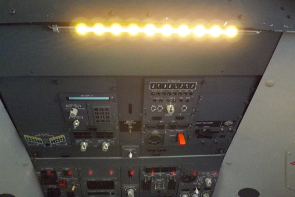

I have used LED strips on the top of the front windows and on the inside at the top rear end in a U channel so that you do not see the LEDs directly. I also have cool white 1/8" fluorescent tubes to light up the MIP & MCP.   All of these help but I think this is not the best solution at all.

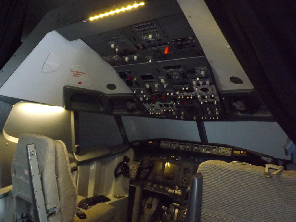

GDay John,
Some pics, hope it helps.
Thanks Nat
Cool white / warm white?
None on the forward  side  and front windows?

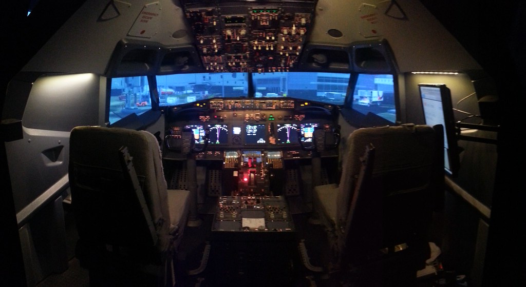

Here are some pictures with the room in total darkness and the projectors turned off. Even like this, I can read charts very well without turning the map lights on. When the projectors are on, the interior is even brighter of course.
I used warm LEDs on top of the windshield but I should have used cool whites instead like in the back of the shell. I think cool white gives a more realistic daylight effect.

Ok, here's a couple I grabbed today. These are with all other lighting and visual system off.
