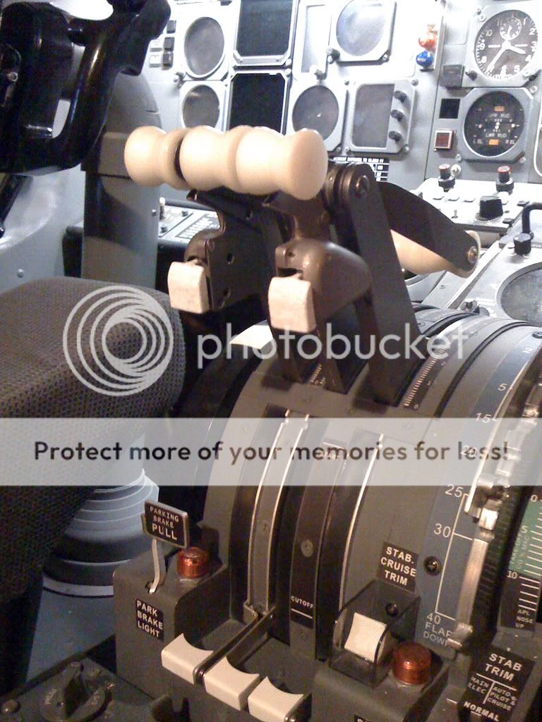

Someone sent these to me a couple of years ago when they decided to modify a 727 throttle into a 737NG throttle.
I finally got around to retro-fitting them to my 727 throttle last night. They don't fit quite right as the upper throttle handle shafts were too thick to fit in the narrow slots in the upper part of the go-around assemblies. Boeing used a thinner steel for this part and mine are made from 1/8" aluminum. I had to do a little cutting and grinding to get them to fit as well as they do now, but if you look closely you can tell they aren't seated in the slot in the go-around mount.
These two buttons (Captain & FO, depending on who is flying) command the flight director to pitch up to 10° for you to follow after a missed approach or go-around. They are marked 'INOP' so they won't be working in my sim either.
I think they look good and adds a little more authenticity and detail.
