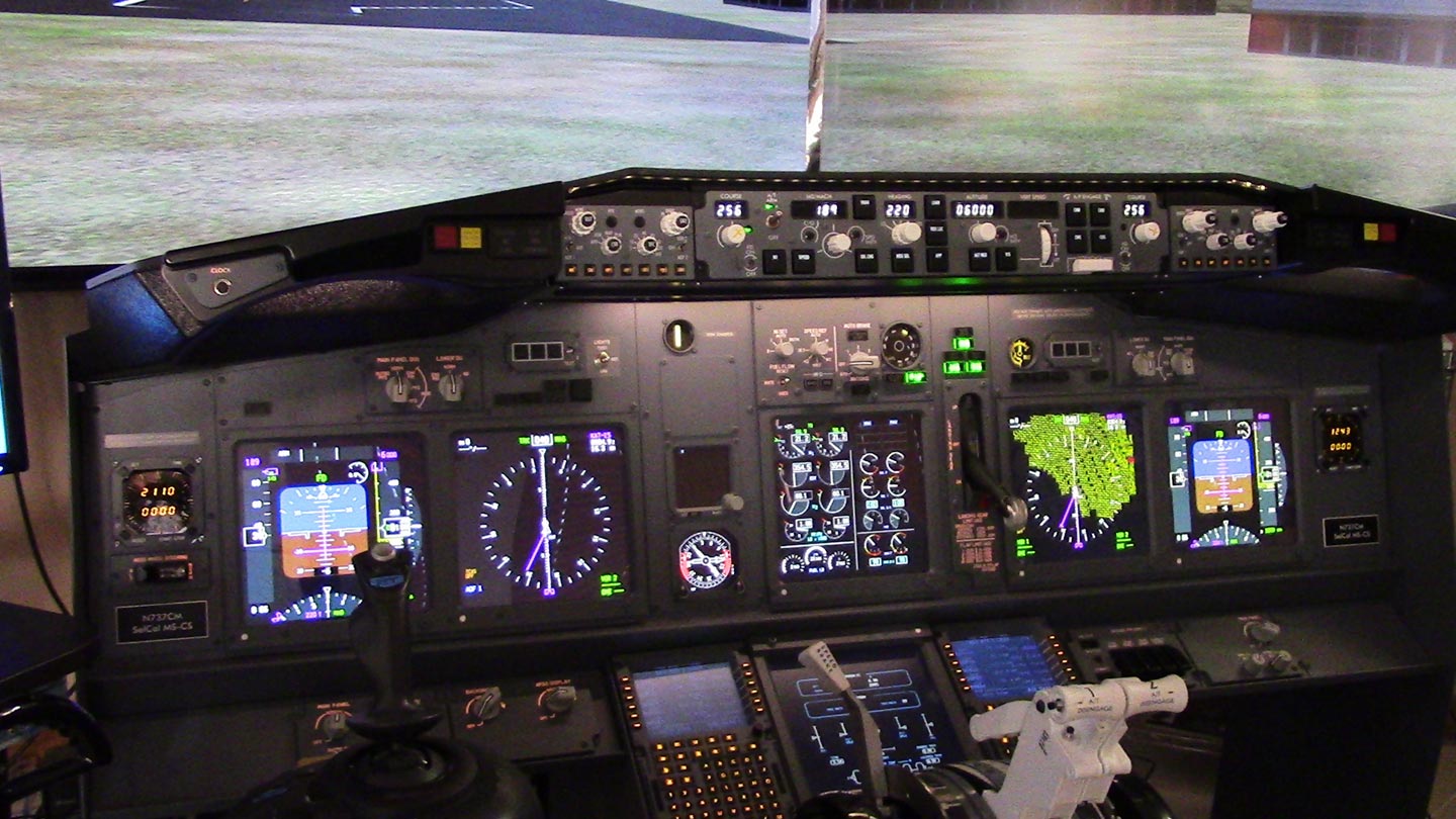

I thought I would share some status on my 737-800 Sim Project, and my experience building up the FDS Fwd Overhead Kit.
I started my Sim Project at the beginning of this year.  At this point, I am fairly comfortable with my FDS MIP operation using FSX and Sim-Avionics.  Overall, I am very pleased with the performance of my current setup, and have had a chance to fly this Sim quite a bit, which now includes flying PilotEdge and many of the Routes for the upcoming CBWF event in a couple of weeks.

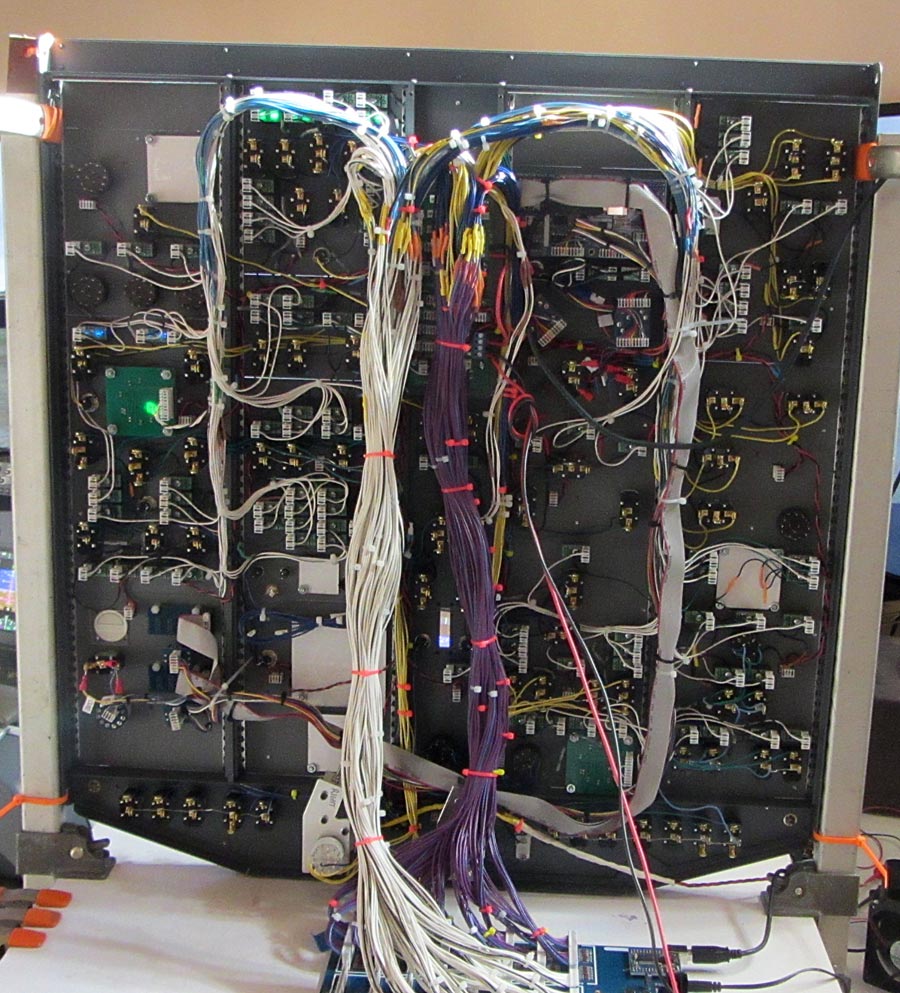

One major milestone was completing the assembly and testing of my FDS Forward Overhead Kit a couple of weeks ago.  I have done a lot of electronic assembly over the decades, and I have to report that this FDS Overhead Kit was a pleasure to build.  All the components were well organized and the assembly instructions were complete.  Although there are a lot of wires to deal with, assembly went smoothly and I was able to test things along the way.
Testing was made easy by the FDS provided XML files, which made this a truly "plug & play" setup when it came time to test each module function on the Overhead, which is interfaced to an FDS SYS1 card using interfaceIT under USB control.  This interface approach by FDS is truly innovative and simple to use, making it easy to assign/modify Offsets as needed.

Here are a few photos showing the MIP and the Overhead with classic "all lights ON" view:

I envy your wiring prowess! Great job there, it's inspiring.

archen
Looks really good Mike! Well done!
What kind of wire did you use?

Hello Anders,
Your wonderful Start Switches are takin' a lickin' and still tickin'  ;D  The Start Switches are a nice addition to the Overhead for my Sim Project.  Thanks again for a great design, and making them available to the rest of us.
In answer to your question...  I used 22 gauge stranded hook-up wire to continue the existing wires included with the FDS Overhead Kit.  The wire was what I had in my shop.  Of course, this added assembly time due to additional connections that needed to be made, plus shrink-wrapping each one.  But it didn't take that much longer, and the electrons don't seem to mind  :)
I suppose it would have been a "cleaner" job if I had purchased a crimping tool and made each wire one continuous link from the SYS1 card to the indicators/switches.  But, it worked out OK for what it needs to do to accomplish the Overhead functions.
The nice thing about the Overhead is that each indicator/switch function sources low current directly from the SYS1 card.  The exception being the IBL Panel Dimming requirement, which requires a minimum of 10 amps @ +5 vdc for the Forward Overhead, and about 4 amps for the AFT Overhead.  In my case, I am using a +5 vdc 20 amp switching power supply, which will provide adequate current for both the Forward and Aft Overhead (when I get it).  The wire from this power supply to the Overhead will need to be a heavier gauge in order to handle the higher current requirement.
The FDS Dimming modules are very compact (nice design) and fit nicely in the upper part of the Forward Overhead.   It is useful to note that the FDS Overhead will require two (2) of these Dimming modules to properly distribute connections to both the Forward and Aft Overhead Panel connections.

Thanks very much Mike for sharing your work. The OVH panel looks very neat and the wiring well organized. I also ordered for FDS OVH panels, SYS 1X & 3X cards, ELEC-CAB unit and their MIP, Nose Section and linings set. I had the idea that the pre-wired SYS card connectors would offer sufficient wire length but apparently that's not the case. So I will have to take the same route as you did. The AWG 22 stranded wire I already have in house will do the job.
For the OVH panels IBL I have in mind to use 2 pairs of 4mm2 flexible wire running from my 5V 20A PSU to limit the voltage loss in the order of 3-5%. Very handy link is: http://circuitcalculator.com/wordpress/?p=75/.

sagrada737
Hello Edward,
Thanks for the encouragement.  I had fun building up the FDS Overhead.  If you are planning to build the FDS kit, I think you be pleased with the end result.
The "wire calculator" is a nice tool.  The last thing you need is a melt-down in your Sim, so selecting the correct wire gauge is important to ensure minimal voltage drop and fire safety.   Since I am locating my +5 volt 20 amp power supply down on my flight deck base, I will use 12 gauge wire up to the Overheads.  The good news is that  the typical setting of the IBL adjustment is less than 50% to obtain a nice panel display, hence the total current draw will be somewhat reasonable.  It's at maximum brightness where you need to ensure adequate current capacity.
