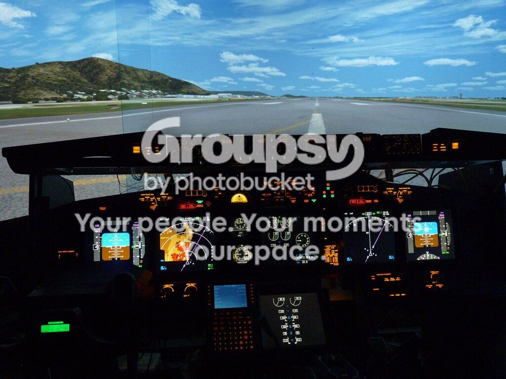

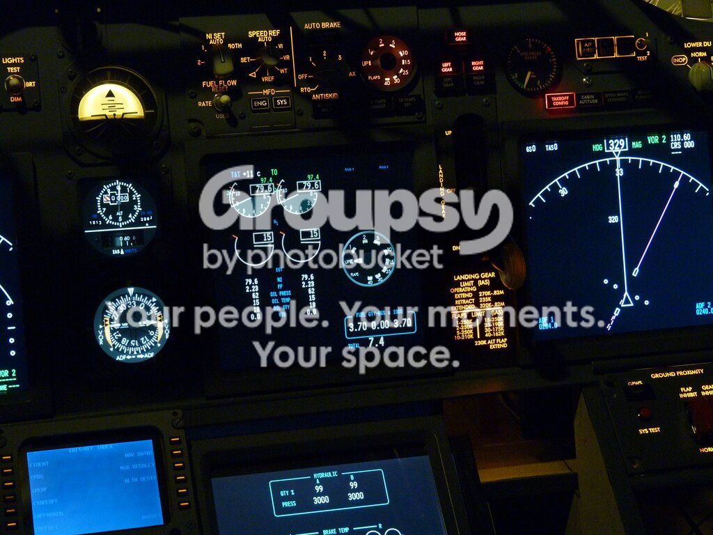

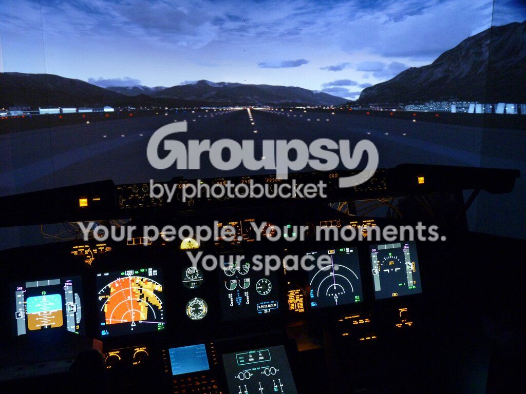

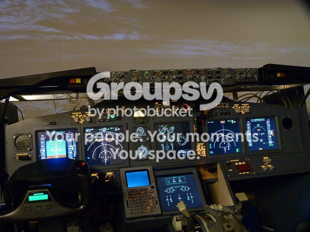

Finally, (7 month later than scheduled  :) ) I have functional MIP.
FDS Signature panels, homemade dimmable backlighting.
MIP is controlled by two Pokeys55 cards, Prosim 737, Jetstream flight model.
Here are the pictures:
Lights test:
Ready to roll:
In flight:

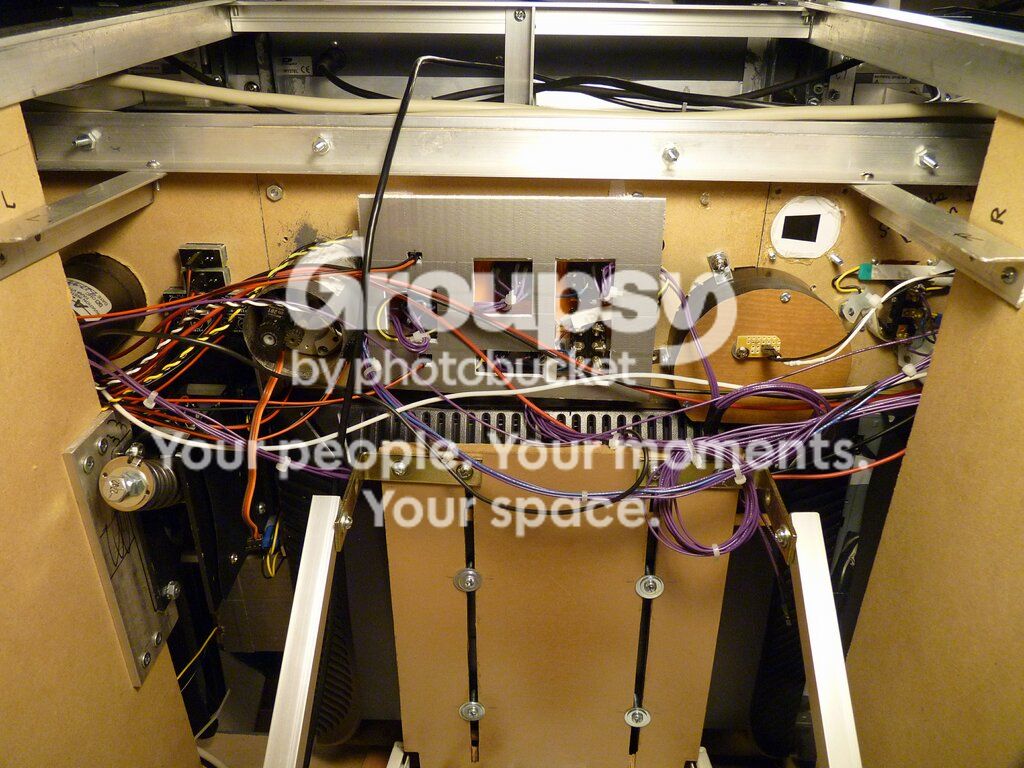

The inside:

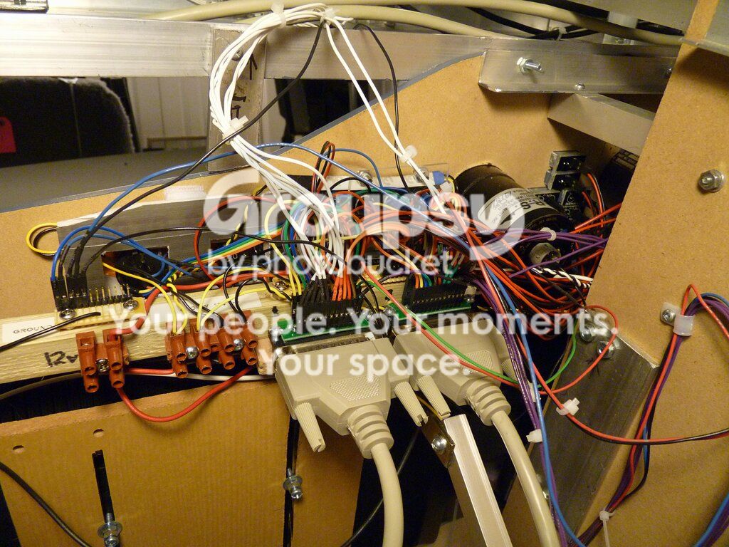

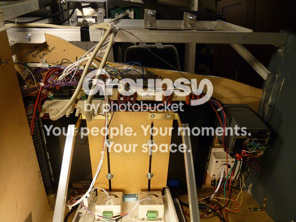

I never liked and idea of directly soldering huge tails of wires running between  MIP elements and control card.
My thanks to Axel (N737AG), who pointed me to the right direction!
So here is my fully modular design  :idiot: Any MIP subpanel can be easily disconnected and removed in minutes for maintenance or repairs.
The control module  with Pokeys 55 cards and LED extension boards (homemade) is connected to actual MIP controls by  4 standard DB-25 cables.
One Pokeys55 operates all annunciators (and two F/O DU brightness inputs) and another one operates all switches (and 4 CPT side DU brightness inputs).
Main computer in addition to visuals runs Prosim 737 System module and Prosim MCP.
