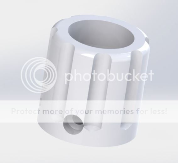

Did a Quickie on my useless Laptop just to give it a shot. This is a 35 minute work, so no details and just using pretty simple designtools. Just free fantasy as I dont have any measures ;)
I see the knobs as a Nice Challenge, but compared to some of what we do at work, this is considered easy.
As I mentioned before, I could be interested in doing the designwork as a sideproject, as I am very interested in these Efis knobs, and also for the Collins MCP  ;)
The slightly offset countersunk hole for the locking screw looks like a Production flaw. I am not interested in duplicating flaws. So if I am going to design these knobs, it will also be on my premices, meaning the holes will not be offset  ;)
I use Solidworks for hobby purposes but also in my Professional life.

Looks good Ivar.
But the absence of radii of the knob!
It should be both radii in the bottom of the track and actually around the whole track. All sharp edges must have radii. 0.2 0.3 0.4 0.5 radii.
Maybe stupid to copy mistake! I only see the details.
What do you think about axle design then? At first hole and then D-shape?
