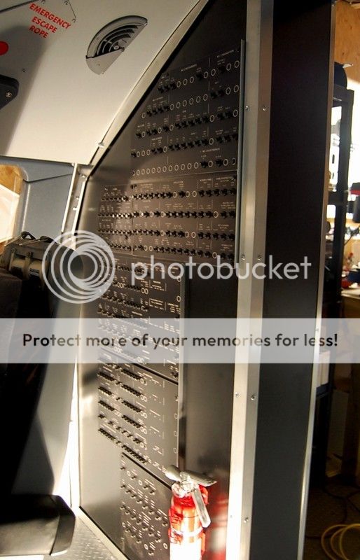

One last thing I'll add is make sure the circuit breaker in your main house breaker panel is functioning correctly. You might have a breaker rated too high for the current draw (Thinking electric stove breaker)
A current draw that high should have tripped the main panel breaker...
I have 3 smoke alarms in my sim room, and a fresh extinguisher nearby at the door.. because.. well... we learn from experience. ::)

Steve, what else is on that same circuit in your house? It has too be something like a high amp motor of a fridge or heater. Check the outlet itself, remove the cover and pullout the plugin unit, do you see any browning. Also, after you replace the PSU power cord and get everything working again; feel along the walls where the circuit is located at and see if it feels hot when using your sim.
I am betting this happened because you used a plugin air mattress pump on the same circuit as you your sim stuff. The pump heated the circuit up, but didn't trip the circuit breaker. So, all the heat on the circuit was looking for a place too go and likely your PSU cord wiring was the "path of least resistance" and caused the thin wires too over heat causing the outer core to melt.
You real problem is decicated circuits for your sim. I bet anything that is what caused this and it will give you more problems in the future... Trust me, if you read some of my old post, you would know that I have been there, done that already.
