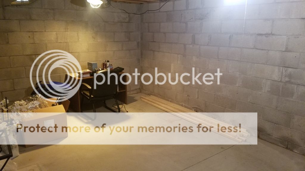

This is the room I have to work with. It's 12ft by 22ft. I think if I can build a 10ft diameter screen the cockpit should fit nicely in the middle

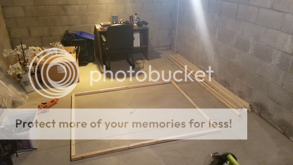

A rough idea on how big the cockpit will be, still a bit messy and have to move the wifes stuff out

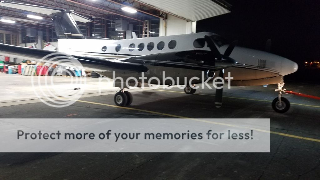

This is one of the 200s I work on and am going to try and emulate

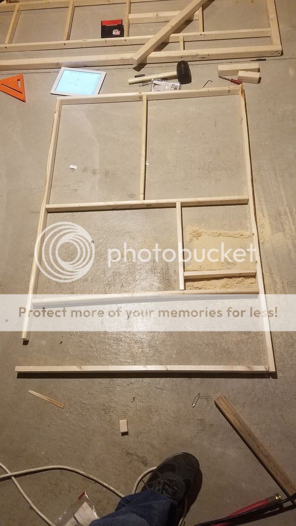

Got the left fuel panel wall cut
And its now time to head to work, guess ill get it all together tonight when I get home.
