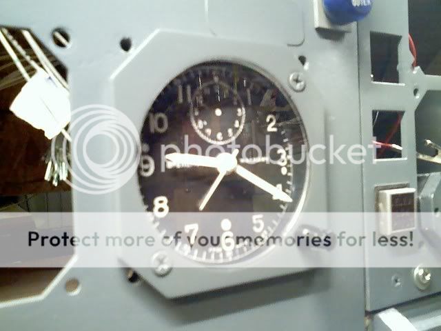

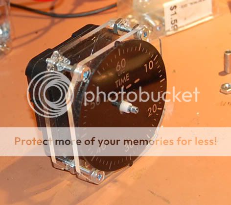

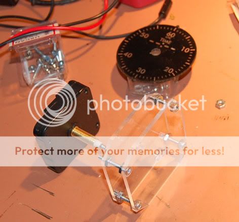

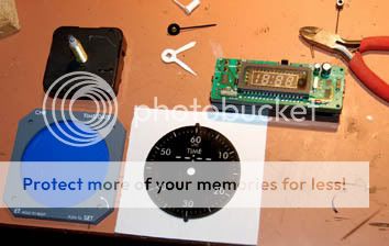

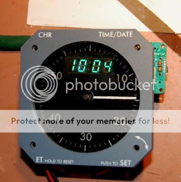

Do you remember  these clocks I posted somewhere else a while ago?
Analog clock movement (less than $10) and digital Toyota car clock ($20 on EBay)
That looks sweet Jack, are you sure you don't have a CNC???
Gwyn
Negative...sure...
The bezels are FDS.
The mechanics are "hacksaw and filing" ice age type by little me. ;D
