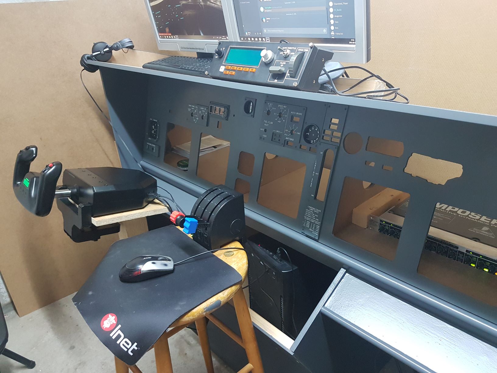

Builds the structure of the 12mm MDF and MIP panel in 6mm MDF. Choose to do this in wood for simplicity. Also ordered the BOEING 737 MIP PANEL KIT from Flightimulatorparts.com so now I await some supplies of buttons and switches, while I wait, I'm looking for monitors that match and paint.
Goteborg
It progresses slowly, color on. Will paint again once all visible components and screens are installed. Counting on some bad luck here and there before everything is in place. :/
Installed computer, some old saitek gadgets to fly throughout the construction time.
My plan is to build one component at a time, install it and thus get a more realistic simulator bit by bit.
The parts from Flightimulatorparts have arrived, are very pleased with the quality. More gadgets, buttons cables come by mail more or less daily so I hope soon I have everything to start the soldering machine.
Determined to buy P3Dv4, I do not know yet if Prosim is the right way to go. So for now, I will use arduino and mobiflight to get started. Simple and cheap solutions.

Nice bit of Behringer audio gear in the MIP i see!

Quote from: mickc on September 21, 2018, 01:48:19 AM
Yeah, now it is not plugged in anymore but its a peice of equipment leftover from a radiostation i started a couple of years ago, i had to use it to make my microphone to sound somewhat reasonable on vatsim. Now i have a new headset so its out of the picture again.
Maybe i use it later on for handheld microphones or something. who knows :D
