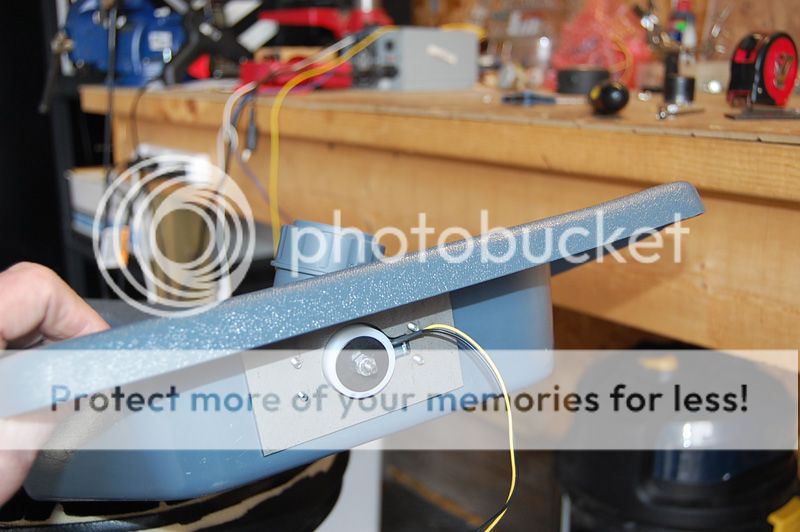

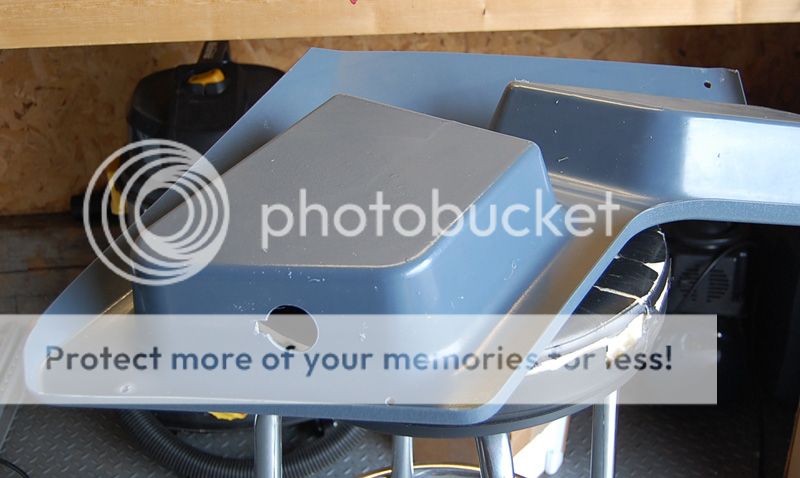

Get the eyebrow off and drill a neat hole with a hole saw and make a small indent (dremmel) for the wire

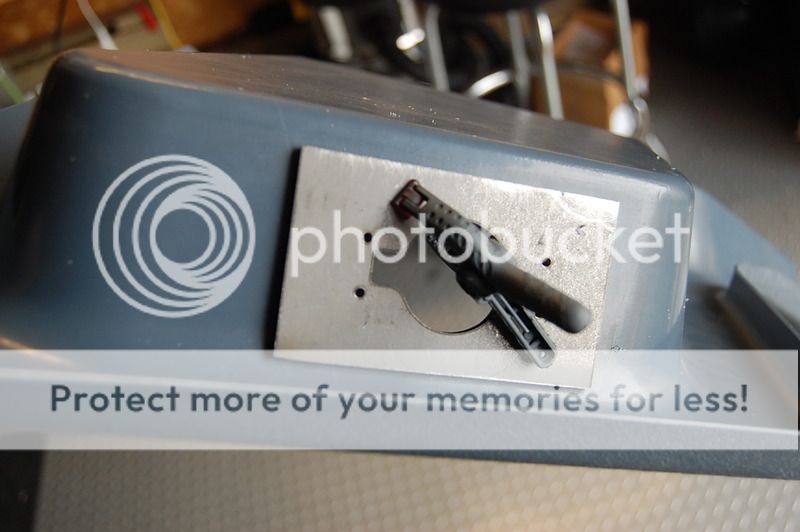

Position the supplied backplate and drill the eyebrow through  the four holes around the opening
(use a mini drill first as a template, as the backplate holes are threaded, then use a bigger one)
Fasten the map light

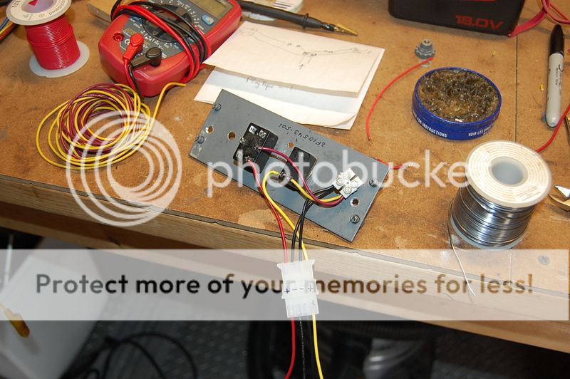

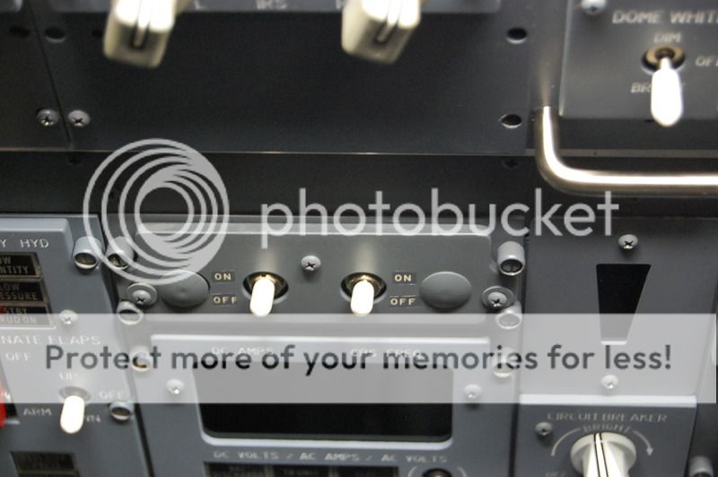

Plan your switches position and wiring + dimmer if you use one.
I opted for an Overhead switch plate as a personal choice
Made the switch plate from an old 747 Ebay plate, resized and repainted.
Could be better but good enough for the time being ..lol

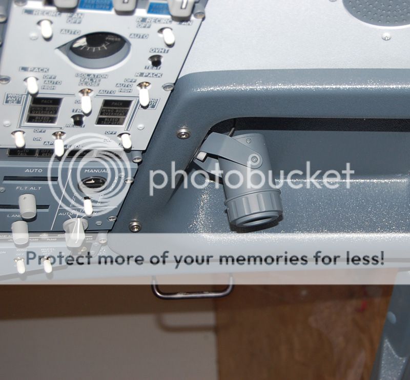

Map light in position
First test :The intensity is perfect without dimmer (Too bright is the picture only)
