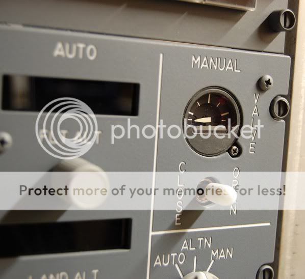

Quote from: XOrionFE on February 27, 2014, 03:40:05 PM
we all have to admit that on some level we have to be nuts.   Now I am thinking about buying a darn FI Brake Pressure guage.  :o
Not to hi-jack the thread  but, while at it, I remind you that the now famous real ½"  is highly desirable too in any cockpit worth its wings!!
(Ask Mau)   :P
