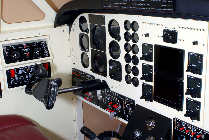

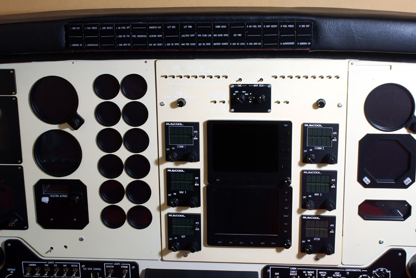

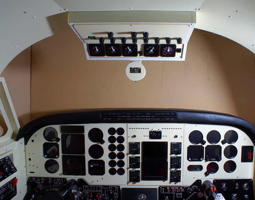

So anyway, I thought I'd start a thread about the King Air C90 simulator that we're currently building for a customer. It's been quite the experience. We've designed and built (and still do) a lot of 737 parts for Pacific Simulators over the years, but this is our first full simulator constructed from scratch and to order.
Here's a couple of photos of the progress as per mid-January or so ...
A few bits and pieces have been added to the cockpit since these pictures were actually taken, but most of the work lately has been focused around the front end, which is finally starting to take shape.
I plan to update this thread with more details as we begin to get the various components all functioning. So far we've only had a few things working in the process of testing various circuitries out etc. (all six radios function, course and heading bugs on both sides work, lamp test all good, fuel gauges both driven okay, rudder boost system operating, LCD gauge panels all organised).
We're currently writing some code for the glareshield annunciator panel because at present not much of it from inside Flight Sim is actually usable. During this process we're also hooking up the various sounds that accompany them too (ie. having the left and right boost pump sounds separated and coming from the appropriate speakers, inverter noises, and so on)
Just a short introductory post about this project, but there'll be more to come ... and hopefully soon!
Any and all questions and/or comments welcome ...
Oh, and there's also a couple of very short videos of the working Rudder Boost System in operation and the rudder pedal movement.
The links to those are as follows: http://www.youtube.com/watch?v=kEe2JL3P7zc and also http://www.youtube.com/watch?v=6EF34qHtXXY

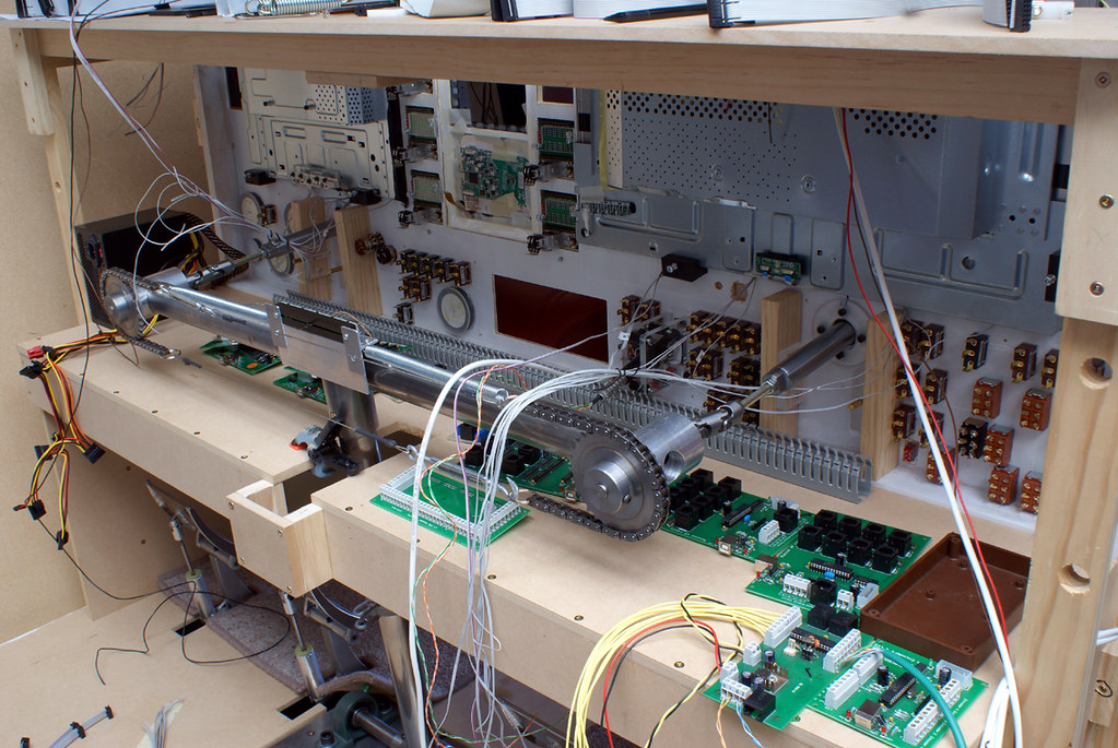

We took a short video of the C90 this morning, as some more wiring has gone in over the past couple of days or so.
None of our I/O boards are actually connected to anything yet (in so much as they're not receiving any information), which explains the nonsensical data showing up on all of the radios at the moment. The annunciators don't know what's going on when they're not under lamp test either, so they're a little random too.
The actual annunciator code will hopefully be finalised in the next few days.
Video: http://www.youtube.com/watch?v=uKas437B17Q
Not a very extensive update I'm afraid - I was kind of hoping that the moving pictures might make up for what I'm lacking in words ...  :)

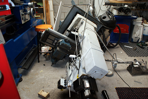

Insurance for the toppled manual mill (pic below) has also now come through (our only major loss), so we're expecting that to turn up shortly as well.
We got off pretty lightly compared to others we know ...
