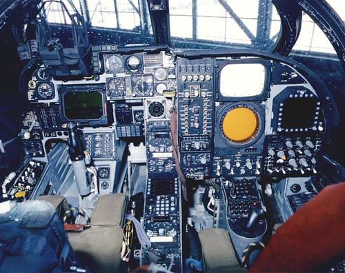

Either the A-6 or the EA-6B (Called the Queerbird by some of us having to fix that piece of flying FOD.....oh I miss it) won't have much for anyone but the pilot to do.
In the Intruder, the BN (Bombadier / navigator) got to look at that radar display you see on the right (albeit through a BN hood not shown in the picture...another maintenance nightmare I could discuss over beers).  The BN had no controls.
In the Queerbird, the Pilot was accompanied by three oxygen suckers called ECMO's Electonics Countermeasure Officers, though most times they flew with less than three.  Those guys had even less to do than the BN, though the EA-6B did sport a fancy gold inlaid canopy glass (which most mechs used to make novelties out of such as Gold inlaid motorcycle windscreens after removing them for the slightest scratch).
So other than the guy flying, the other folks would have absolutely nothing to do as nobody models a BN station or the ECMO stations (highly classified)

Yeah ive got enough pics of A-6 and Prowler cockpits i just need to find out what they all are/do.

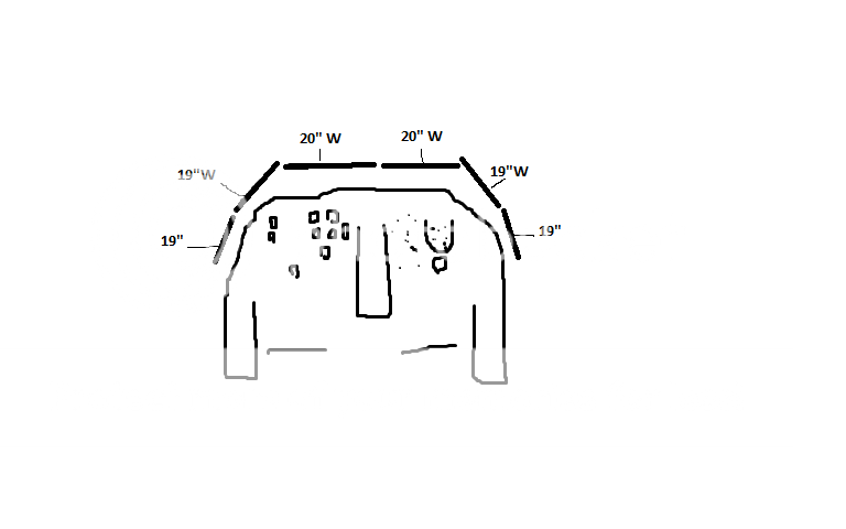

Another idea we have is we're thinking on using this setup for the monitors. (apologies for the roughness of the drawing, im at work on a touchpad laptop)
Being you worked on these planes in real life you'll get what my scratchings mean, but problems with multi monitors of differing ages can mean colour problems and other compatibility issues, as were just looting ebay for whatever we can really of all ages. Still not sure the differing sizes would work either would they? They're all the same height at least right?
I'll tackle the last one first.....

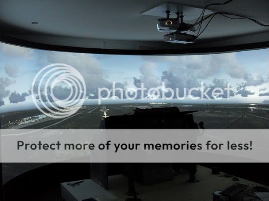

You might be better off with Projectors for an outside view if you have at least a 10 x 10 or better size space to work with.
Running a span of 6 views is going to crush the frame rates on even a high end card an capable PC.  To get there today you would need either two Matrox TripleHead2Go's and a couple video cards, an eyefinity AMD card (I think it does 6), or multiple PC's and vid cards (with this you're back to FS9 ro FSX and WideView as I don't know another game that supports that.
On that note, you are limited in other games by what the developer coded for views, or what you can tweak a config file to give you.  Beyond that you just end up with a stretched version of a normal view (not what you want I'm sure).
With a few PJ's and some warping software and a TripleHead2Go or Eyefinity card you can get closer to this:

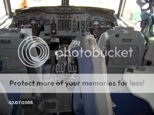

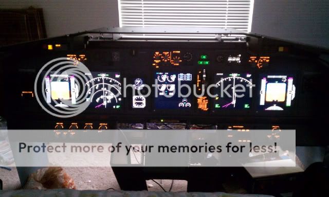

Here's my 737 in its current state:
The area you see that are backlit are different panels, made usually of plexi, painted and etched (laser) so the light shows.  there's different ways of doing the backlighting, these are with real A/C 5v bulbs, however LEDs are more cost effective for a home project.  Helps to have the switch or knob legend lit up when you are flying in the dark or a dark room so you know what you are reaching for.
The displays are actually two 19" widescreen for the Captain and F/O PFD and ND displays and a 15" 4:3 for the EICAS (center).  So your idea of using a monitor and cutting a faceplate to sit in front of it and dividing the guages across that monitor are very doable, however you need to find a plane (if using FSX) or a game (if using some other program) that allows you to undock your guages and move them, else you're stuck with the way they appear on the screen and have to work your monitor cover around that .  Not as easy.
To run what I have in the above picture, I use a i5-650, 8GB with two vide cards, one output for each 19", one for the 15" and another for the CDU not shown in the picture.  I will add one more PC to drive the Lower MFD (note shown) as well as the F/O CDU.  Visuals and the sim itself are driven by another PC.

The left 3 monitors are my friends PC. The right 3 monitors are my PC. They will be seperate views and indeed maybe look a bit off if hes behind me in game for an Apache ride lets say, however meantime we have the SU-34 in ArmA 2 with side by side seating, but yes we're making exceptions in that if one of us uses freelook it will detach the screens and go crazy, but we dont mind that as most of the time it will be a proper linked view at least.
If we get a plane that carries 3 the third guy in the back will have yet another seperate PC of his own and have his own setup again.
For your last post,  thats a really ace looking setup, and i understand ArmA doesnt allow undocking of guages (as an example of a game we play), but if you see here this is a mod in the works we're hoping gets finished-

Hey John, who's projection setup is that, it's fantastic!
Sean
It's either Ivar or Nat's, can't remember where I poached the example from

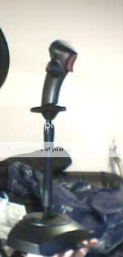

The stick is a- to be fair quite cheap one we had sitting about made by Genius that we extended the shaft on.
But has great functionality, landing AH-6's on a penny, however as you may see I think its a bit lop sided (or so it looks as its my friends pics and i just noticed now), but can always put it in another more tighter joystick base like a Logitech extreme 3d pro we have lying around, otherwise that looks the most like the Intruder stick, was looking at a TopGun stick just to detatch the handle
But read its quite small and more for kids, plus ive decently large hands.

Fighter MFD??
Those sticks look great, bit on the pricy side, might grab one over time, going to get the pit up and going with what we have for now. But thanks alot!
I did see some real navigator switches on there for not too bad a price, so may get those
http://cgi.ebay.com/USN-Grumman-A-6-Intruder-Tacan-Navigation-Console-Box-/370498483855?pt=LH_DefaultDomain_0&hash=item56436e368f
-edit- in hindsight i think i didnt make sense, the stick is perfect, but if theres a cheap joystick that looks a bit like the real thing were going with that for now is all, but prob will in future, its just so it looks the part for now, seeing as we have that gear lying around as well.
