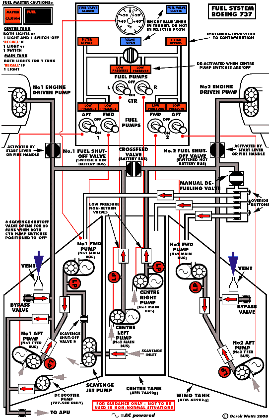

- Just a small tip : the 737 APU always uses fuel from pump number 1 ;-) Here is a scheme of the fuel system :

Thanks regarding the APU.   I am aware of it but as I said in the video I was just really firing stuff up fast and not really following a flow...just testing stuff.  Hard to cram everything in a 10 minute video...lol.   Actually don't have to turn on the pump but it is recommended if you will be operating the APU for any length of time in order to save the life of the APU fuel control but it is not required.
