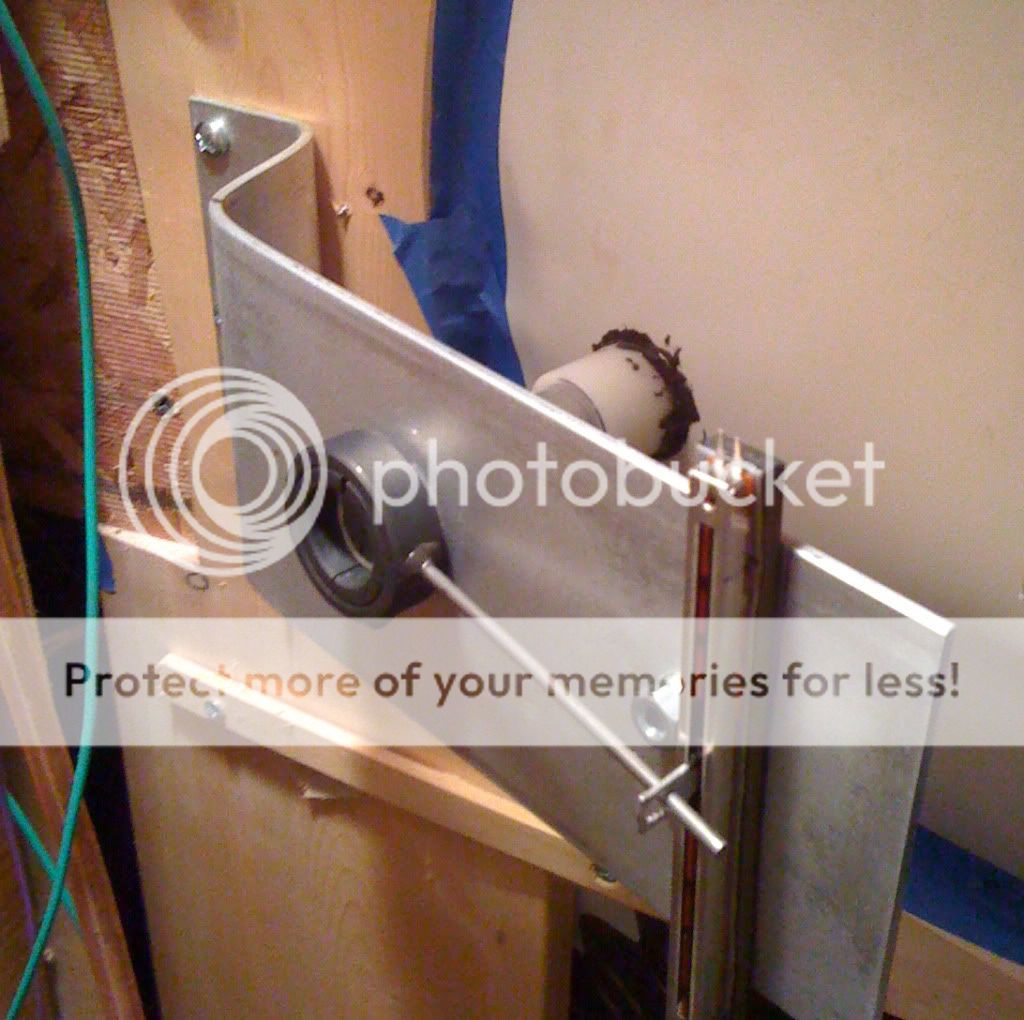

This is what's behind the sidewall. I don't think there is any feeling on it other than the cable tension and the nosewheel tying to return to center in the turn.

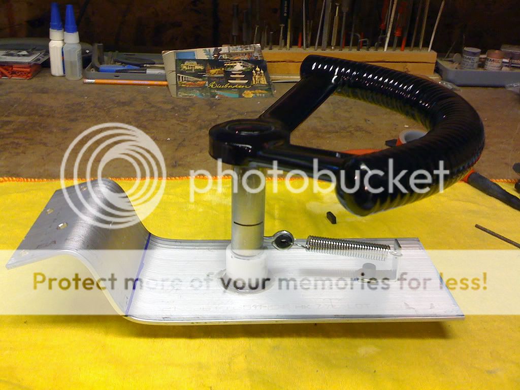

I think I will use a small clutch as a break  on the axle, set for a light tension, and that will do the trick.
Maybe having a straight alu bar extending on each side of the axle with a light spring (extension) at each end could simulate the centering action of the wheel?

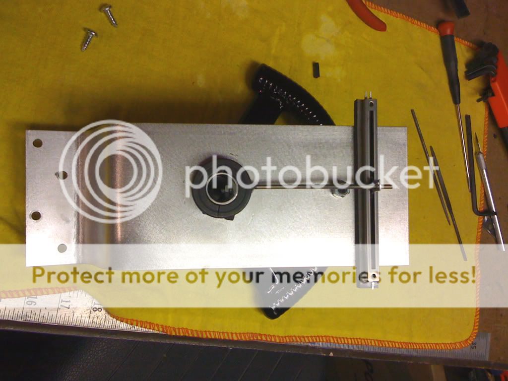

I worked on the tension setup and seting up the pot yesterday. I had a lot of ideas for this but none were any simpler than this.
When assembled into the sidewall there is quite a bit of smooth friction already from the shaft collars pressing against the Delrin bushings so not much of a spring was needed. It's not so much a centering spring as something that just increases the force needed to turn the wheel as you turn it farther.
The pot was set up very simply too. A hole was drilled in the rear shaft collar and a hardened steel rod was JB Welded into it and set at an upward angle (can't be seen in the photo) to intercept the toggle on the slide pot. This setup gives 100mm of travel with a minumum of parts.
I disassembled the mechanism and installed it into the sim last night, but I've yet to wire it and test it. Pot is 10K and gives a nice smooth linear reading on the meter.
Pot is mounted with 3M automotive trim tape to a 3/16" piece of foam board which in turn is mounted to the aluminum mount.

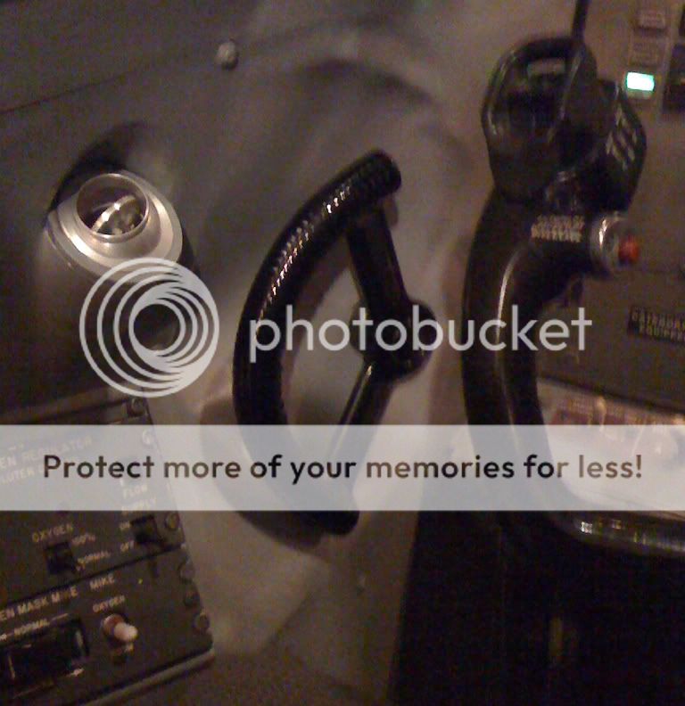

Installed in sidewall:
I think I mounted it almost an inch too low. Too late now. I should have checked closer but it's tough to get in there to see very well.
Mike,
It looks fantastic..  Absolutely Stunning.  I wouldn't have noticed the height issue, if you hadn't mentioned it.  Just WOW!
