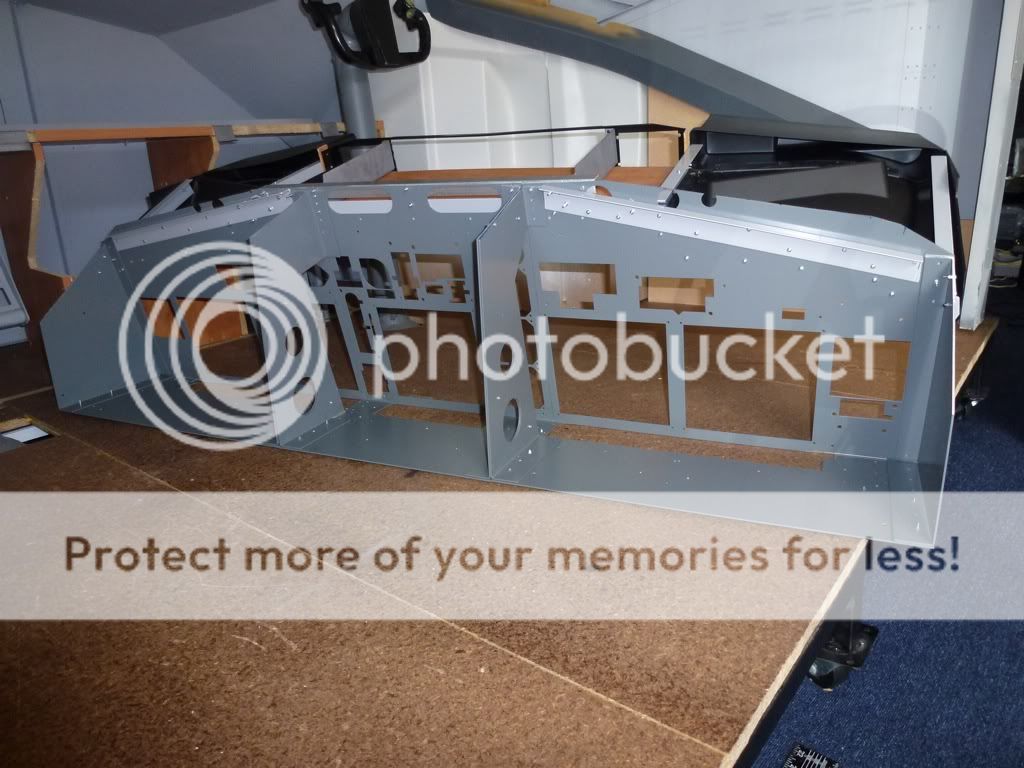

Hi Guys

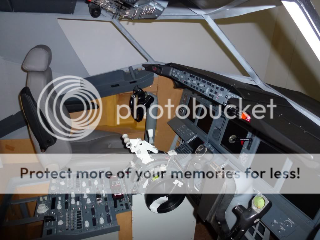

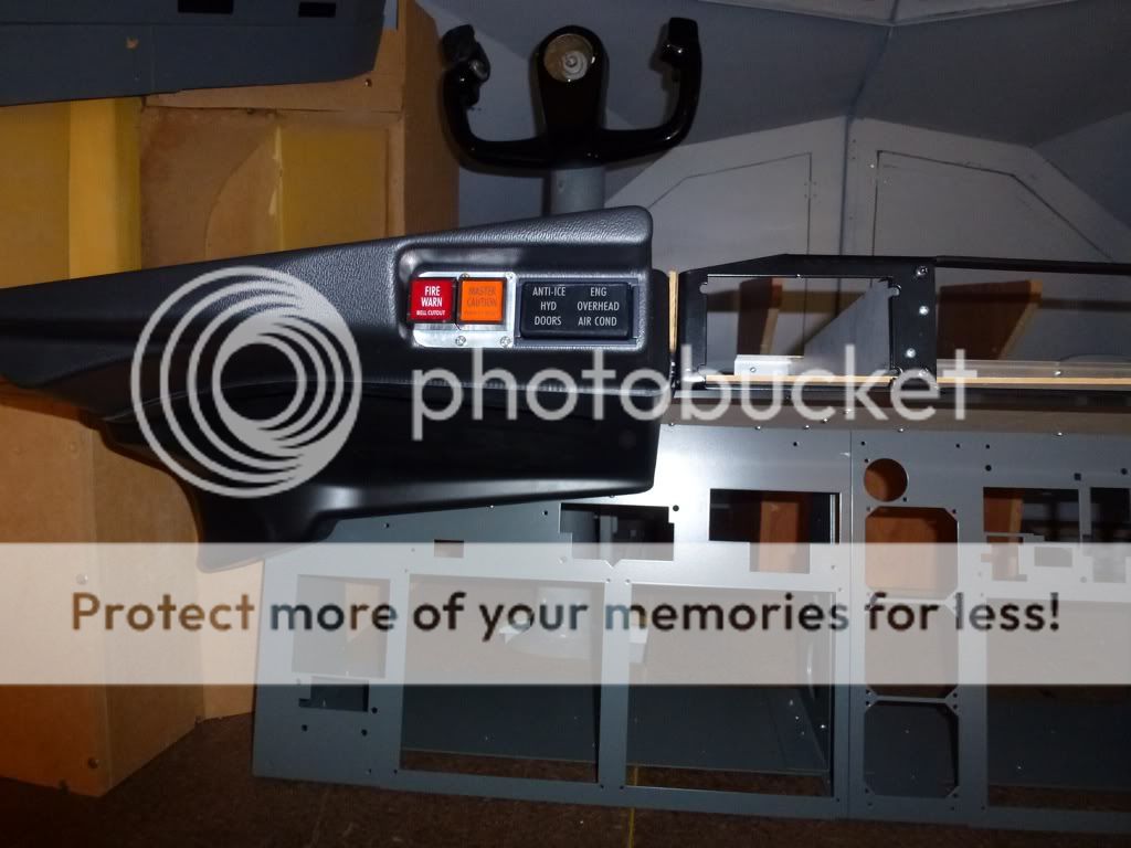

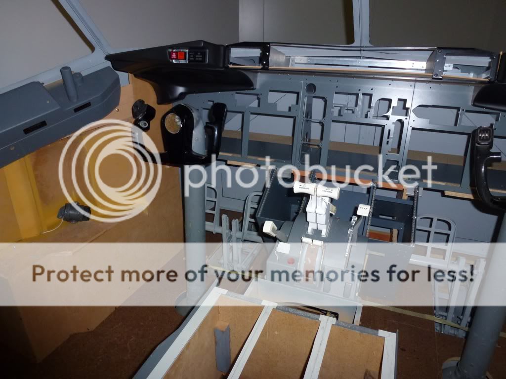

Well some progress over the holidays.  Using the Simworld MIP frame with FlyEngravity Glareshields (inc Fire/Caution and six pack recallrecall).  The Simworld MIP frame is built well, but shaped for sitting on a desktop, so some surgery was required to get it into the nose section.  As Simworld don't currently have a frame to support the MCP/EFIS a customised extension was needed to support the CP Flight MCP and EFIS.  Also had to do some minor surgery on the FDS CDU frame, but all in all I'm pretty happy on our things have come together from different manufacturers.
Thought I'd add some strengthening for good measure.
Also had to prune the glareshield to fit it in, a little nerve racking as I didn't what to bust  it and interesting things can happen when cutting plastic....  Mounted the six pack recall straight into the glareshield but decided that the fire and caution switches should sit on a panel so they can be extracted from the front.
Put it all back together tonight so I can start working on the panel lighting tomorrow.
And if you are wondering about some of the unusual patterns on the wood throughout the interior of the pit, its an old television cabinet.  The ultimate in recycling :)
Peter

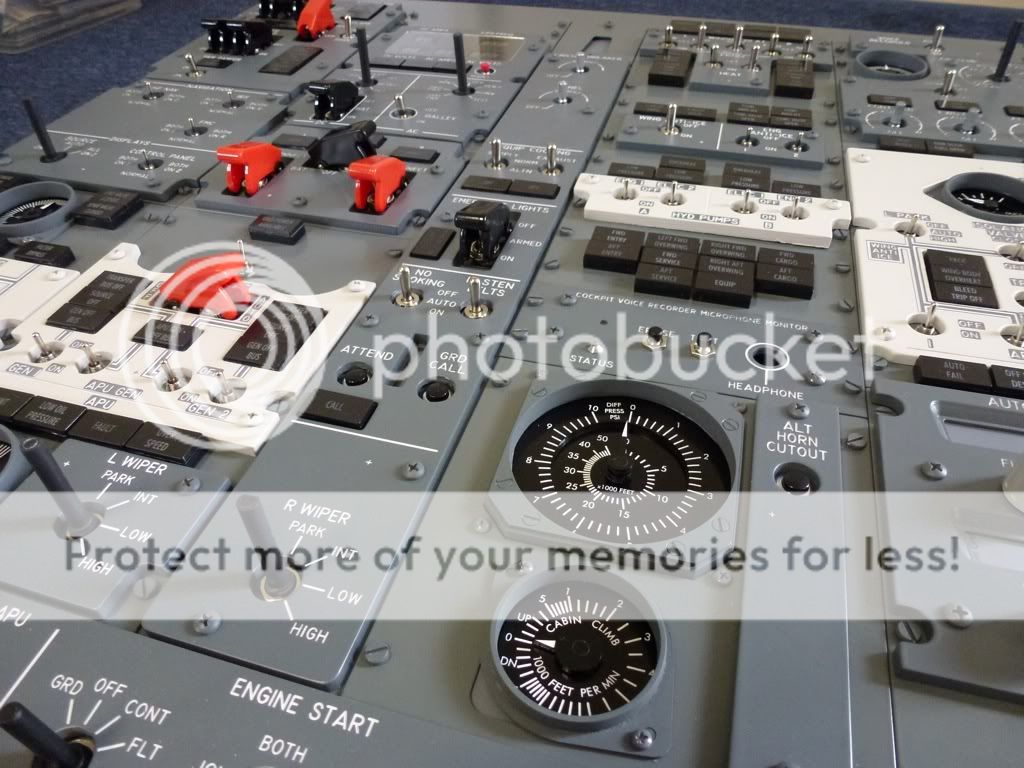

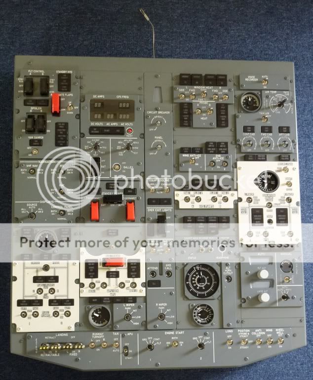

Hi guys

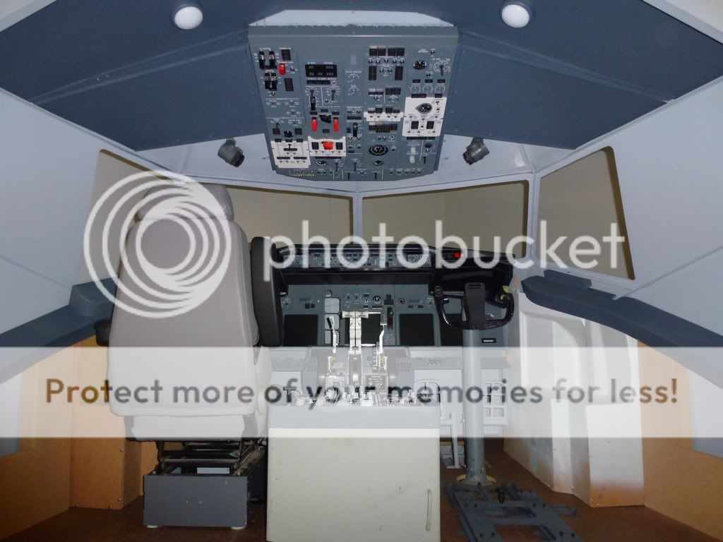

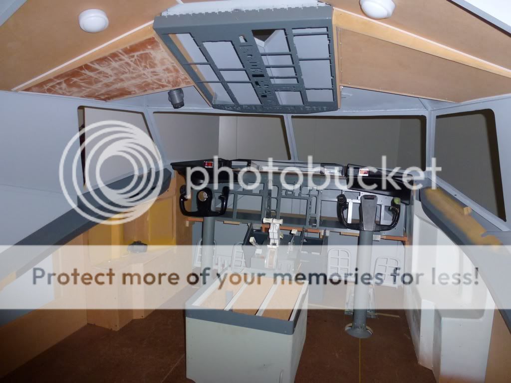

A little more progress on the Fwd OH.  This is a Simworld frame and panels, with  Opencockpits Gauges and Opencockpits legend indicators.  Very happy with the Simworld kit, although mounting the OpenCockpits gauges did get a little interesting., nothing a bit of filing and drilling couldn't fix (all part of the fun).  Now doing the mechanical stuff for the MIP.
The wire at the top is the safety strap should anything go astray when mounting it.

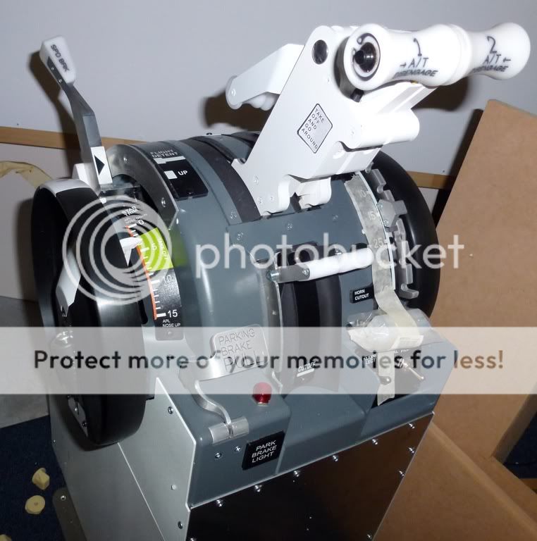

And after a 'few' months, the Revolution Simproducts throttle has landed.  Yet to spin it up, but it is a nice piece of work.
Peter

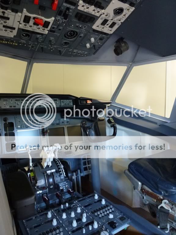

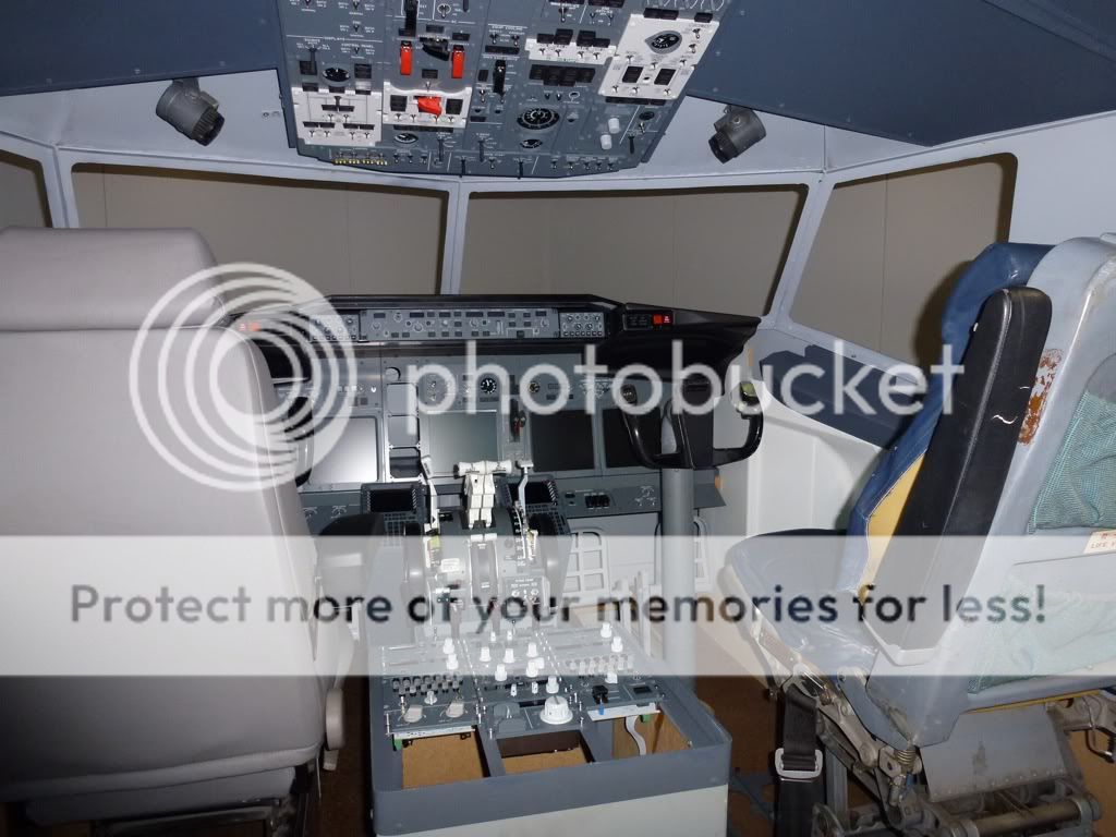

bnepethomas
Starting to really come together.
What the photos don't show is the Revolution Simproducts J-Rail on the FOs seat.   They are nice pieces of work.  Makes the cockpit shuffle a whole lot easier.
Still tossing up what to do re instruments in the centre of the MIP.
Just about at the point of doing the wiring thing, hopefully no blue smoke :)
And then there is the FO seat to fix-up.. builders work is never done.....
