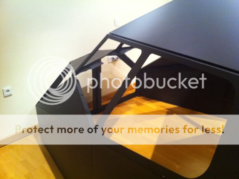

I'am almost finished my base on which the FDS Nose Section should perfectly fit. A square platform would be to large for my room.
The dimensions (in mm) are:
Front width = 1700
Aft width = 2495
Depth = 2137
Flight deck Height = 260
Al tubing: 60x60x4

sagrada737
Very nice job of designing and construction on your flight deck Base Assembly.  I just received my FDS Nose Section, and I have in mind a similar design.  Thanks for posting the photos, as it really helps me to better understand the layout.
I like the footprint profile of the Base.  It seems to make more sense over a square platform.  Also, the wheels on the base seem essential.
By the way...   It looks like a nice job of welding the aluminum.  Did you do the welding yourself?  I plan on using thin-wall 2" x 2"  steel tubing for my design.  I was advised by FDS that it might be a good idea to establish the top of the Base at 18", which allow for better access.  Any thoughts on this dimension with regard to your approach?
Thanks for sharing.

Hey Mike,
The frame has been welded by a small company for € 650 (material and labor, 1 day work). Since Al is is about the same price as Fe, I chose for Al and TIG welding.
I assume that your advised 18" is the height of the flight deck above the ground. Quite high I must say. You must be sure to have sufficient ceiling height (2500 mm in my case) with respect to projector mounting. My 260 mm is based on the max height of the control column mechanism below the flight deck. I don't see a reason to make it higher than strictly necessary and I do not intend to crawl under the base for doing maintenance.
Edward
