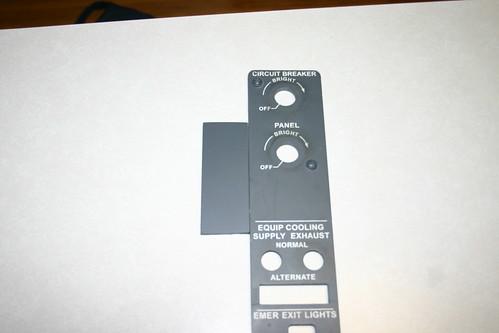

I just took my real Boeing panels to Home Depot yesterday and had a batch of Boeing gray latex paint made for the wood parts of my pit.     I then took the panel to a local Auto Paint store and they mixed me up a batch of this wonderful interior auto paint that goes on smooth with my airbrush and requires no matte clearcoat as the paint already has the proper flattening agents in it.   It dried hard to touch in about 20 minutes and this stuff is rock hard and extremely durable.   I am really pleased with it and ready to start painting my homemade panel parts.   The match with the real boeing panel is perfect on color and sheen.

The Paint is from PPG and is called Deltron (DIU Interior).   The color is actually a FORD color called Medium Portland Gray.
There is a breakdown of color parts also as follows:
DMD664  Black   227.7
DMD663 White   147.1
DMD614 Blue  32.2
DMD641 Yellow  17.1
DMD622 Red Oxide 4.7
DMD656 RED  1.9
DX685  Urethane Flattening Agent 66.4
DBX695 CLEAR  61.2
I mixed this with DRR Reducer 50-50 before putting through my airbrush.   Worked perfectly.  There is also a spray they gave me to spray the plastic with called Plastic Adhesion Promoter.   You just scuff sand the plastic with a scuff pad then lightly dust it with the Adhesion Promoter prior to shooting the paint.   There is no final clearcoat required.    This is the same paint type used on plastic parts inside autosmobiles for their plastic panels and is extremely durable.   Here is a picture of the test piece I shot sitting next to the actual Boeing panel.   As you can see the color and sheen is pretty close to perfect.    At least with my eyes I cannot see a difference at all.    This photo was taken with a flash so you can see the effect of the flat finish on both panels.  Note Shane that for the Learjet the Gunship Grey Testors paint is the right color.   This color is for Boeing and would be darker than the Lear panels.
