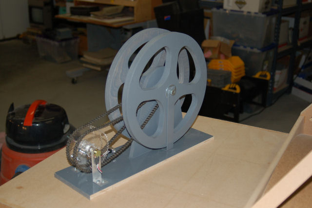

First, here's the completed Trim/Flap wheel assembly:
You can see the other pictures on it here: http://www.simpits.org/geneb/?p=147
I also cover the new rudder pedal installation and locking pins for them.

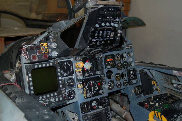

...and now Jet Pr0n! :)
More pictures are here: http://www.f15sim.com/?p=159

That looks really amazing. Are you using 400 Hz power for the MIP?
Whaooo, very nice fighter!!
I do not know about you guys, but when I see a picture like that, my first reaction is to forget Heavy metal and join the Mach+ crowd!!!
Ha! those steam gauges !
very very nice, congrats.
geneb
Heheh.  Thanks!
If it doesn't have a big rotating disc on it or a fuel probe hanging off the back end, it's just another target to me. *laughs*
The ADI & HSI are the only instruments that are 400Hz AC.  They'll be driven by the digital to synchro circuits that Mike Powell designed in his new book, "Building Recreational Flight Simulators".  They're dog cheap to build, especially considering when a commercial DtoS converter *starts* at $500 per channel.  The backup AI will also be a 400Hz device - nobody builds a "simulated" AI that has full 360 degree rotation on the pitch & roll axes.
