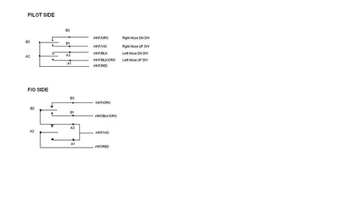

This is confusing.   I have two different yokes which are from different planes and they have different types of switches.    Maybe they are different though because of being captain versus First Office side.
The switches have wiring diagrams on them but I for the life of me cant figure out the best way to wire it.  I used the Red/Wht on the Cpt side as a common gnd and was able to test each switch position with a continuity tester and came up with the switch position for each which I wrote down.
On the F/O side though I havent a clue.   This probably works more like Trevor's idea.   Only on this one there are only 4 wires instead of 5.
Can anyone help suggest how to wire these.   Making them work like Trevor said would be the way to go I think but I cant figure out how.   I have attached a diagram of each type.  If it doesnt show big enough on this site you can also go to this link. http://farm3.static.flickr.com/2766/4179139983_af4a70ace6_o.jpg

This looks like it would work great but the problem is that these types of switches are wired like two seperate switches shown and the units are sealed with only the wires shown on the diagram coming out.   I think they are internally wired a certain way as the diagrams I sent show.   So there is not two seperate ground terminals for instance.
OK, sorry, I thought you had a wire for every terminal.
Then if that is the case and on the Pilot side wiring diagram, you would need a relay to connect to that, to make it work  the way you want it too.
Lat me see what I can figure out for that.  Assuming these wiring diagrams are all you have access to. I do have tonnes and tonnes of relays too, so if I needed to send you a couple, that wouldn't be an issue.

OK, for the F/O Side.. it is very easy to wire..
Connect White/Red to Input card Common
Connect White/Orange to (Trim Up) Input
Connect White/Black/Orange to (Trim Down) Input.
White/Violet.. = NO CONNECTION
Easy no problem..

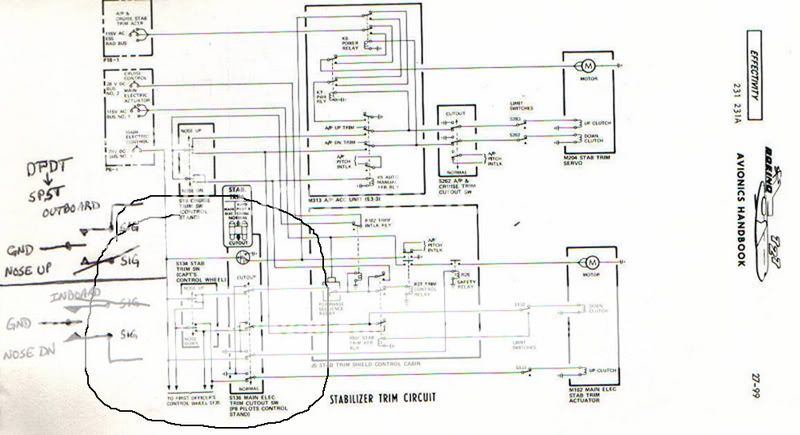

Here is the Captain Solution..
I can give you the diagram from the Boeing manual that I used, but for the life of me I can't remember how I wired them. Mine both have to be pressed together to get the trim to work. One or the other will not do anything.
It was so long ago I don't remember how I did this and I can't see the wiring.

Hi Guys, Dont mean to take anything away from this thread but I think the Trim switch is being made overly complicated. On the real aircraft one of the switches is used as an electrical ground to the actuator which of course makes the trim system electrically incomplete without both of those switches used together. It isnt for the independant use of hydraulic systems A or B which I think is a misunderstanding.
Using the diagram on the switch and a multimeter I was able to find the grounds and up/down of the switch pretty easily, but like Mike that was a long time ago. As long as you have those, the actual ground switch for the actuator can stay unwired, unless of course you would like to simulate trim system malfunctions as well.
Awesome...Appreciate that Gary..  My dual trim system for my old Falcon 900B was set up  dual hydraulic systems, I assumed the 737 would be similar. That was a misunderstanding regarding the behind the scenes operation,  however..  My circuit diagram for Scott will still work, as the left switch will allow the right one to operate as you stated.
Your welcome Trevor. Yep your diagram will still work for sure. With mine I just have the one switch wired up into the interface. The other side just goes along for the ride :-)
