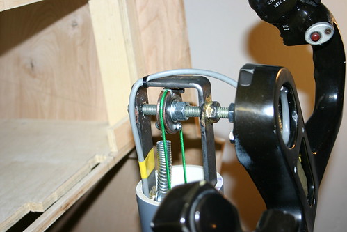

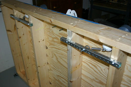

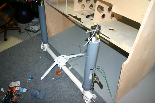

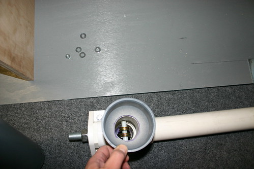

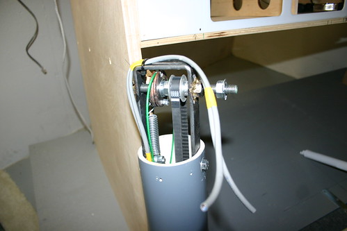

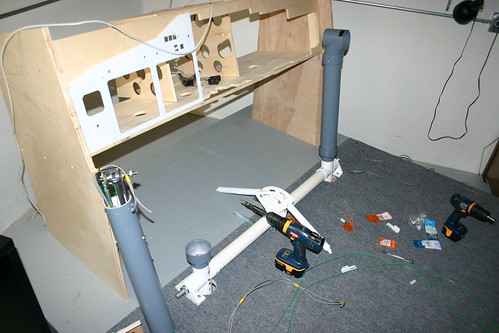

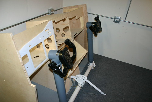

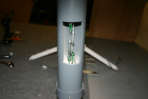

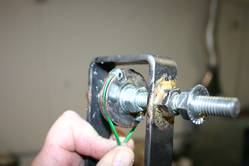

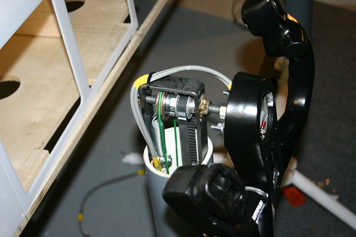

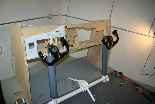

Here are some more project pictures.     Everything is working now although I am still playing a little with springs and door closer adjustments.  I may change out the lower springs to elastic bungees instead.  The pulleys work perfect and yokes turn together in perfect harmony!  Thank you to Trevor for the method of locking the cables from slipping on the pulleys and also providing a way to adjust (while I couldnt find the locking wire nuts you mentioned Trevor, you gave me the idea to use wheel collars instead which work similiar, thanks).     Wiring of switchs and pots to come next but thanks again to Trevor and Michael I shoudl have that solved soon.    Note that the crossover tube and door closer mechanisms will be closed in with covers and by the TQ base.  Once complete I plan on making a short video to post with all in motion.

Looking great! I wouldn't think that material would be stiff enough, but since you built it I guess it is anyway.
I have a dualyoke project going to. As with all my other projects, it's a v.2.0 but I think I have it this time ;)
What is the "thingy" on the middle of the crossbar? and is there coming a TQ on top of that later on? I smell some interference.

The PVC is plenty strong with the exception of the crossbar which could be stiffer.   It may be better to have the crossbar made of steel pipe and I may change it out later.    The only problem with the PVC cross pipe is that it can twist (tortional weakness).   It is not too bad but just enough that with the weight of the yokes on top of the columns they can create enough momemtum if you move them in jerky fashion that when one side is moving real fast then stopped (pitch) the other has a tendency to want to keep going from intertia.  This is noticible mainly in the form of unwanted feedback through the crossbar.  That said, real pilots don't jerk their yokes around like that in pitch.    If you fly normally then there is no problem at all and it is plenty strong.
The contraption in the middle of the crossbar is for dampening.  You need to use two gas struts and I chose two screen door openers available at your local homecenter based on a friend of mines design.  He also cut the two pieces you see in the middle from HDPE that they ride in.    Will this interfere with the TQ?  Possibly...   But only at the bottom which for me is not a problem because I am making my TQ from the Simparts.de kit and it has room at the bottom for this.   Anyone trying to do this should be taking that into account during their planning.

PVC pipe is very stong and very tough stuff, but as you said, torsionally weak in the thinner schedules. And gets worse with length. Possibly a piece of hard copper pipe in that diameter could be used?
