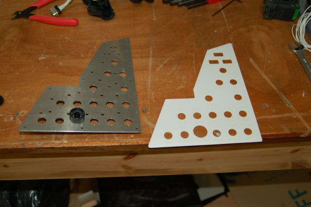

That's a picture of the new left sub-panel for my Me-109F/X project.  I'm going to be cutting the main instrument panel today!

Brilliant Gene!  They look so real, fantastic, you must be quite happy seeing this come together.
Five cautious hours that've indeed been well spent. Beautiful work! Nice engraving too.

Trev:  "looks real"?  It's control panel sonny, not a silicone implant. If COURSE it looks real!  :laugh:
Dean: Thanks.  I need to order more .125" cutters today too. *laughs*
With any luck I'll be able to cut the acrylic edge-lit panel for it today as well.

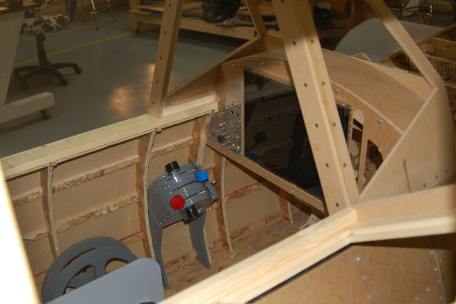

I carved up a block of UHMW today - holy crap does that make a mess. :)
Here's a pic of today's work:
More detail on the blog - http://www.simpits.org/geneb
You can see the mess I made with the UHMW at http://www.f15sim.com
