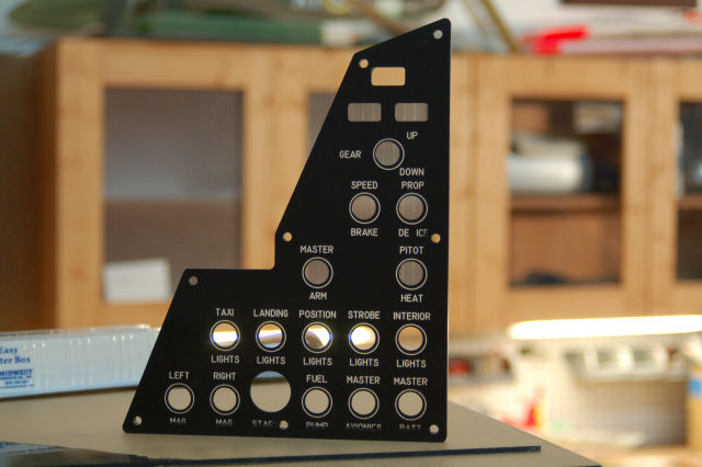

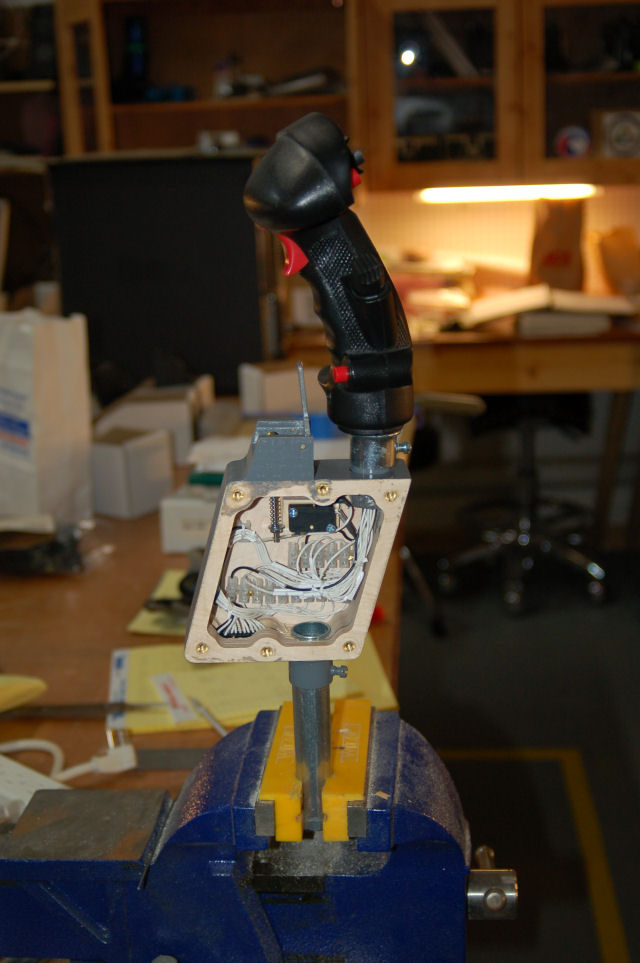

The grip assembly for the 109F/X is done!
The edge lit panel for the left sub-panel turned out really well:

Today I was able to complete the wiring harness that brings the wiring to the front of the cockpit from the db25 connector on the gimbal mounting plate.  I had a horrible headache that drove me out of the shop.  With any luck I'll get the new harness terminated and get the Plasma v1 I have hooked up to do initial control tests.

If anyone out there wants to see a cheap way of building a single stick gimbal, check out http://www.geneb.org/pitkit/jentron_mk2.  It's very easy to build and can be done with nothing more than a drill and a hacksaw.

This thing is a mess. ;)  I tried using 180 degree FOV "warm white" LEDs for the panel illumination and ended up with a pile of hot spots because the LED isn't long enough to penetrate the mounting panel deeply enough to deliver all the light it produces.  That and ever one of the damn things (14) are mounted on a 3/8" square circuit board.  ::)
