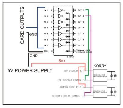

sstusek
I flew over this topic superficial. Anyway I think I got the idea of the problem, to light up a korry.
This PoExtBus 8 relays board is one possible solutions but as stated above, sort of expensive.
You could try ULN2003A chip (a high voltage and high current Darlington array)? That is what I used for my Airbus Korry`s. With IOcard output sygnal and suitable external power source, 24v or 28v (max 50v), ULN2003A can light up to and 500mA. If your korrys pull 80mA you can connect up to six korrys to one ULN2003A.
You get 100pcs for $10-$15 on ebay, that is less than $0.1 per korry, to light it up, and a lot of soldering :)
Here is my simlpe diagram for ULN2003 connection. I use OpenCockpits boards! I hope it is more or less understandable.
http://www.ti.com/lit/ds/symlink/uln2003a.pdf
Simon
Ethanoost
Hi Simon
I like what I'm seeing. I will research that idea. Can I contact you if I need help?
So the card outputs from a pokeys card can be directly connected to the chip inputs. The chip then forms a switch to ground which can handle 0.5A at 28v. Correct?
Thank you for that advice.
Ethan
KyleH
That looks like a good idea.
Maybe I'll try that on my next board layout instead of relays.
The one thing I couldn't find in the datasheet is power ratings. I wonder how warm it would get if all the lights on its output are on for a period of time.
I see that the outputs can be paralleled, so you could theoretically get an amp output if needed.
Kyle

Danilo
#17
Of course the outputs (and inputs) of ULN2003A can be paralleled to enlarge current capability.
Furthermore, ground connected to pin 9 will turn on ALL outputs, which can be used for testing of lights without using any software command.
Happy soldering!
