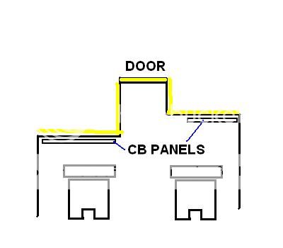

Building my back wall.
Would someone have these measurements (in yellow), as the section behind the capt seems a bit  further back (for the jumpseat I suppose)

Markus gives the distance from the door to the bulkhead but I figured the Capt bulhead was not level with the FO's.
Actually I may be wrong and my drawing should be as below (both CBpanels at the same level)and an encroachment for the jumpseat.
Not clear (to me ) on Markus drawing

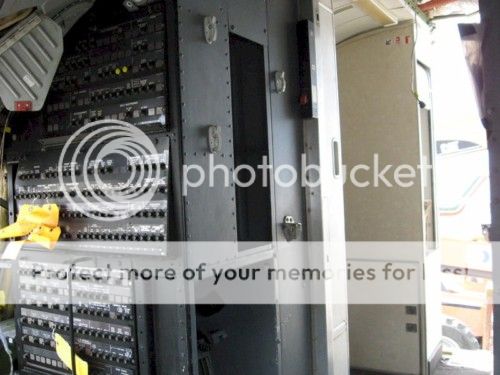

Someone uploaded these a while back, and I kept them for reference when I do my back wall.  Hope it helps, Jack.  Please take lots of pics as that is on my short list if I ever finish wiring the MIP

Hi Jack,
I can confirm both the captain and FO panels are in the same level, with a recess for the observer seat.

Hey Jack,
Okay, the pic you have shows three lines, but here are pics of mine and I used the actual B737 sizes. However, you must adjust for the thickness of your building material; I used 1/2 inch plywood for mine.
You will see in the attachments a closeup pic of the measurement, and then a wide shot of the area it is for under that. They will be coupled like that throughout...
