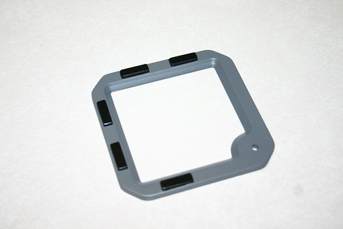

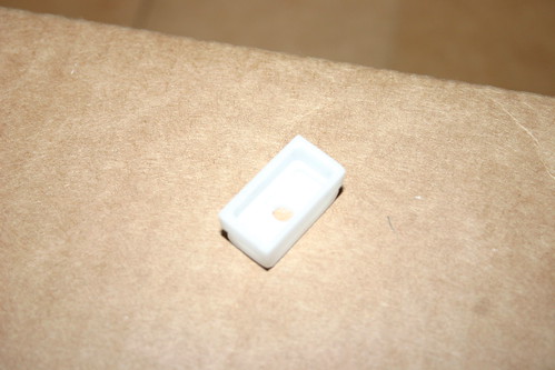

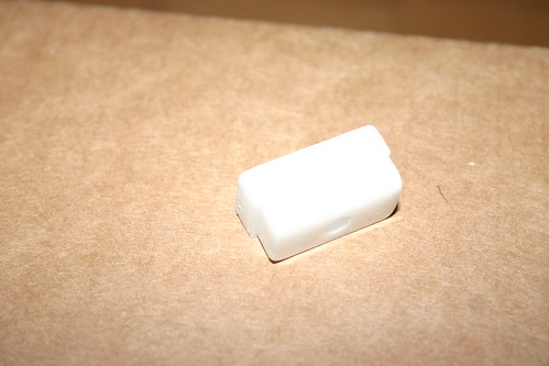

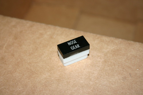

The first three pictures are of my homemade korry indicator housing.  I looked at what OC was offering and I have purchased some of their mip panels that came with the indicator lenses but not the holders so I decided to make my own on my cnc.   The lense you see attached to my housing in the third picture is from Open Cockpits. I have made some with single 5mm LED provisions and some with dual.   I have tested with some leds I got from China on ebay that worked perfect.
The last picture is of my homemade ISIS panel bezel so far.   I intend to engrave the buttons and the bezel next and also backlight.   I still need to cut a knob (Nihad? :-) ).   I also made an RMI bezel.   This bezel is as close to scale as I could create given the pictures I was given.  Again, my friend Vince helped me with the drawing and toolpath setup which I would be happy to share with anyone if you want it.

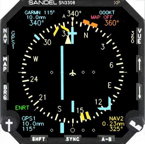

Is it possible for you to make one of those bezels with a different button arrangement, except for actually cutting the holes for the buttons? I'll be fabricating the buttons to actuate tactile switches behind the buttons.
I need a bezel cut for for the Sandel SN3308.

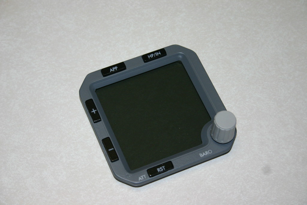

Here is the completed panel.    I am happy about the engraving for the most part but need to get some more opaque white plastic.  The plastic I used is sign white which is a little more washed out due to its transparency for light.  This looks great when backlit but in normal light it is not vivid enough in my opinion.  Of course nothing compared to what can be accomplished with laser engraving but not bad for home cnc.   The buttons on this are non-functional but I could have easily made them so.   The Baro knob is on an encoder so it could be interfaced if there was a function within the software used.

Ivar, the buttons aren't functional on this one but that was just a matter of choice.   I am relying on Sim-Avionics to supply the ISIS display but I dont know if it will actually have functionality.  If it does...then I may need to remake this panel :-)
