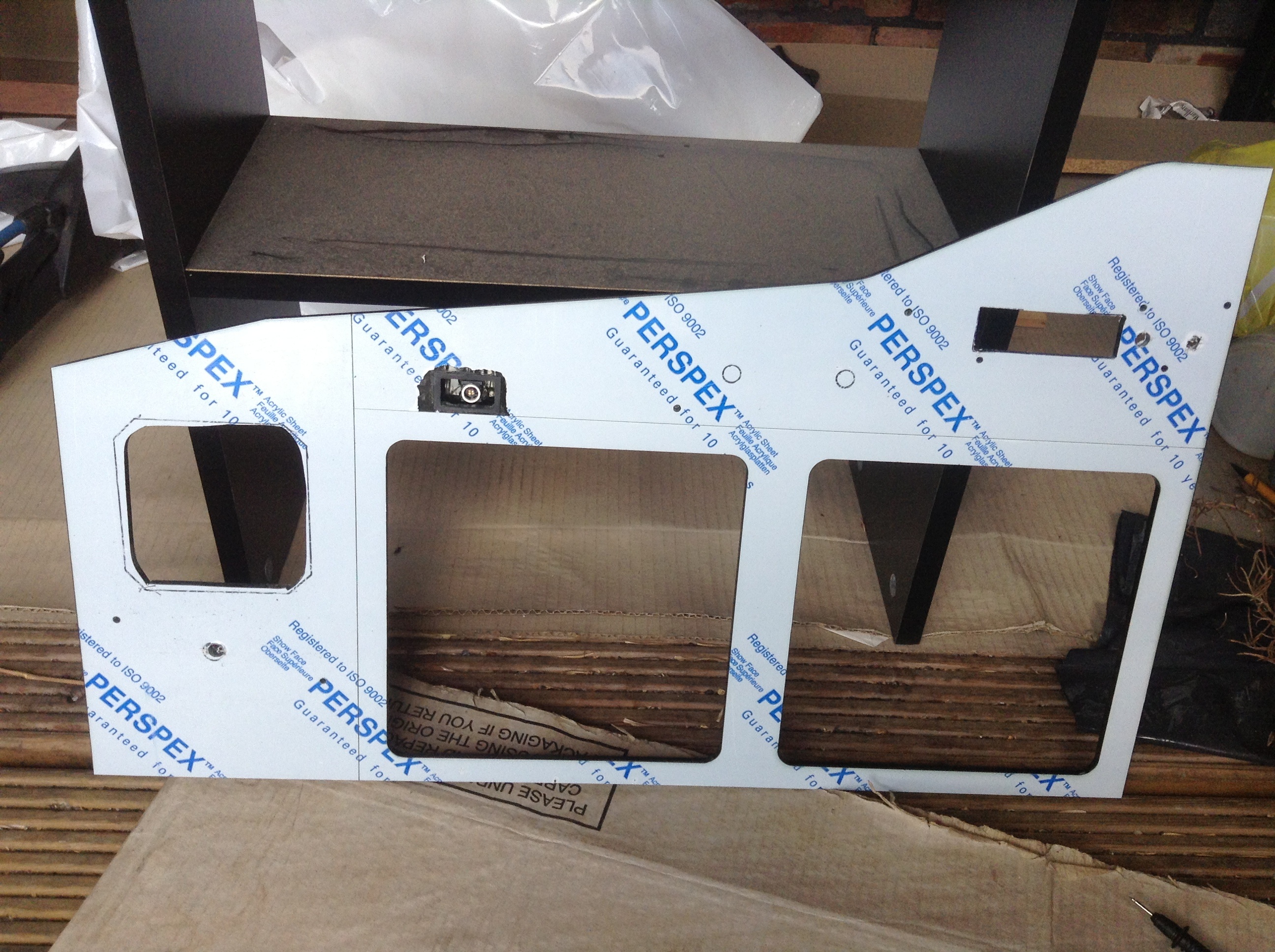

I tried cutting the MIP from a left over bit of wood from some disassembled drawers but realised this wasn't the way to go.
After a bit of googling I decided to use acrylic/perspex for the MIP and get it laser cut. There are loads of places online and in london that can do this. I found various illustrator files but found the scales were all a bit dodgy so I created my own. Its attached here.
I only drew the outline and the cutouts for the LCD screens as I wasn't sure on the measurements. This was a mistake, cutting the other various holes has been a bit of a nightmare, particularly the smaller ones like for the "below GS inhib",   so the next panel will have all the cutouts marked from the start for the laser cut. For example, because the cut for the "below GS inhib" was a bit ragged I cut a small outline panel/frame to cover it from 0.5mm ABS.
The MIP cost about 30 quid to cut including the perspex, it was 8mm thick.
The first switch I've put in as I mentioned is the below GS inhibit. This is both an annunciator and switch. I bought the Captains Panel set from opencockpits.
After cutting the hole I cut some smaller peices of perspex to make the back to mount the switch, welded using some plastic weld - great stuff. I used a MEC5G illuminated switch, soldered up the wires from the LED and switch and terminated them on a bit of veroboard.
First switch

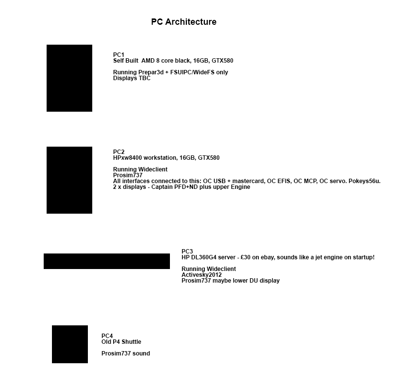

This my proposed PC architecture.
I've got all this stuff but none of it is up yet until I move house - I've been granted use of the converted attic until my girlfriend says otherwise  ;)
The HP DL360G4 was an interesting purchase for 30 quid on ebay. 2 x 3.8Ghz xeons, its going to run the weather and maybe a prosim display. Problem is, being a rack server, it sounds like an APU on startup!
