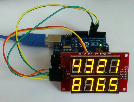

I discovered that for 1/2 (ONE HALF!) the price of a SINGLE COMM/NAV radio from FlightIllusion, I can assemble 6 (SIX!) of these:
using a single arduino or teensy, (for all six)
One of these:
..plus a few switches, some smoked plexiglass and a dual rotary encoder.
Savings: Well over $1600 US.
The included Arduino LED library for the display makes it sooper-simple to program a COMM or NAV radio and send the values to X-Plane.

Ray I'd be interested to see the Arduino code for this, if you don't mind.
And I think you'll need another element to those displays for the radios.
I am guessing Ray you would just Hard Solder a #1 in front of those numbers?
Seems to be missing a digit LOL
RayS
I plan on just super-gluing a "+1" single digit to the left of each bar. I have several hundred of any color in the rainbow at my disposal so.. should be easy.
Joe, I worked on the  INC/DEC code last night for the lower 2 digits and got that working to correctly go from a .00 .02 .05 .07 .10 .12 (and reverse)
I should be putting in the rest of the code over the weekend. Pretty easy so far. :-)
