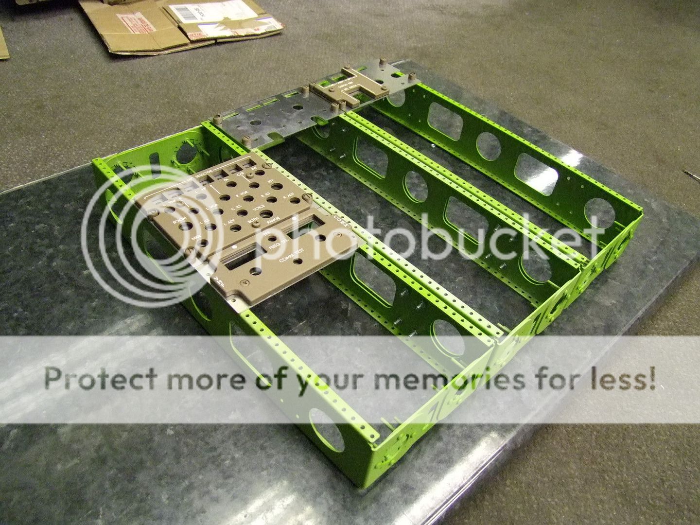

Would some one have info on that greenish primer/paint that we see on aerospace aluminum parts, and a source for it if avail

I use Dupli-Color etching primer for aluminum. Same green color used by the industry, and it stays on!

The apple green is a good substitute. Available at Home Depot and sometimes Lowes if you are in the USA.
What i do is use a normal 2K acid etch primer, usually in grey then applhy a second coat using some sort of green colour, cant help you chaps in the US but in the uk Halfords Rover Applejack is spot on :)
Obviously its Matt in finish but dont worry, using an gloss aerosol spray at a distance of over 16 inches away, do what i call a dry coat, the paint is almost dry when it lands. i do it on some of my stuff and its bomb proof :)

Found today the Dupli-color etching primer at a NAPA Store, $6.00 a Spray can and the color is the right yearchy  green, as Mike mentionned.

Glad you found some. It sands nicely too without a lot of clogging.
Mike, what type of paint did you use over it?
I will leave the inside of the TQ in green primer but I have to paint the box outside in grey.
I've used Krylon Rust-Tuff in Battleship Gray, and when I couldn't find that anymore, I switched to Duplicolor New Ford Gray ceramic engine paint.
Both good paints and adhere very well.
