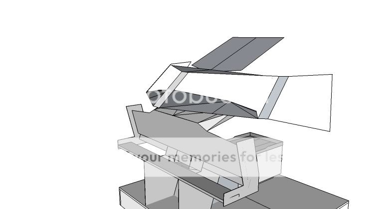

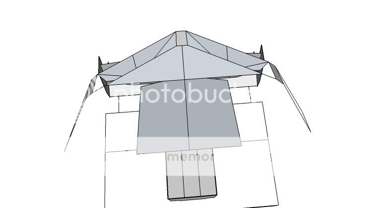

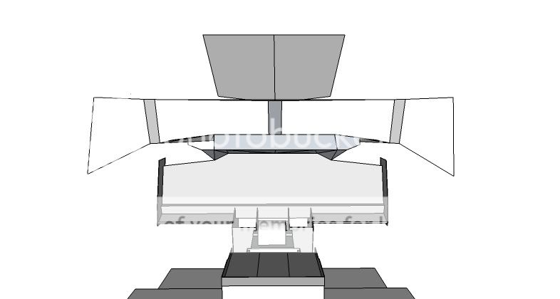

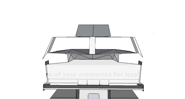

From one view it looks ok but from another not so ok. Guess I have to solve the puzzle "live".
Straight in from front (well not quite quite):
Straight in from back (cockpit):
From the top:
Just another view:
Measurements looks to be ok.
Made in Sketchup.
Drawings look good. In the top photo, the front glass has no breaks on the bottom edge. It's a straight piece of glass and the nose has hard edges that reflects this.
Unless I'm looking at it wrong...
