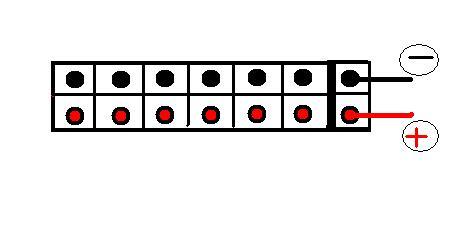

Hi Guys
Looking for some kind of Bus bar to distribute power (5V and 12V) like that:
I found some but the wiring  (20GA) seems flimsy.
Jack I use these... and have lots..
I use one for 12V, One for Gnd and one for 5v.  I insert jumpers in the back and wire in the front.
Let me know if you want some.
Yep I know these (european)
I am trying to avoid the jumper trick and have each row  fed by one input.

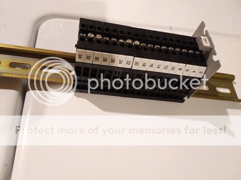

Hi Jack, here's what I've got:
Entrelec M4/6-5116
UL Ratings: 10-16 AWG wire, 600V 25A
I have:
  • 50 Position black
  • 34 pos black
  • 30 pos grey
  • 34 pos orange
I can break them down into 10 or 20 position blocks depending on what you need.
I've also got a few DIN rails to mount them too.
EDIT:
Just re-read your first post. These are just higher current bus bars. They are separated in blocks, not one side from the other. May not be what your looking for.
Kyle
