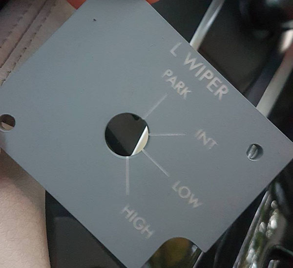

What I've tried so far, is getting opal white acrylic, figuring that when I paint it, and then remove the paint, I would get high contrast white. Yes, but no. This is my try:
http://kazey.flitepal.com/cockpit_build/backlit_panels/wiper_2.jpg
This has been painted black, and then with gray-blueish color, then laser engraved. The laser seems to burn the paint and leaves the acrylic with with some grayish shadowy color. Not what I desire to achieve. I did not apply white, because a) I am using opal acrylic and b) I am afraid the result will be the same.

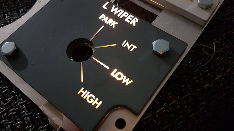

However, once backlit, it looks okay:
http://kazey.flitepal.com/cockpit_build/backlit_panels/22641966_10214242823895493_1532820798_o.jpg
But I want high contrast white when not backlit.
Does anyone have the secret?

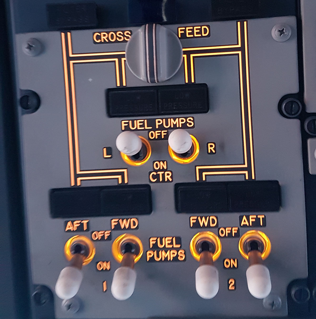

Hi Ivan
Same goal for me, i have almost reach it, look here, on page 15 ....
http://www.aircockpit.com/viewtopic.php?f=100&t=5409&start=140
Michel

MCrevot
Franck'
Yours are also great, i can only strongly recommend them !
