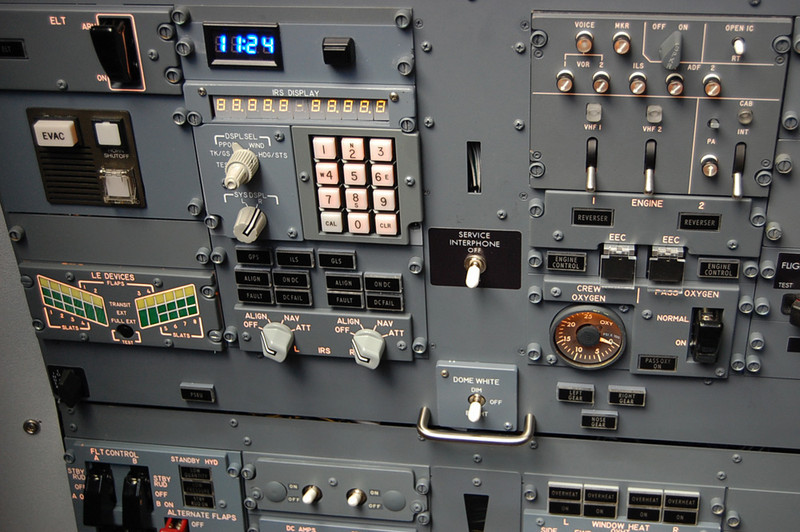

navymustang
Your observer audio panel is radically different than what I have seen in other sims, including mine. Can you describe why its different.
Thanks
Real unit, brand new (ie: never used) that was idling on a shelve.
Looks real good (IMHO)  ;D
