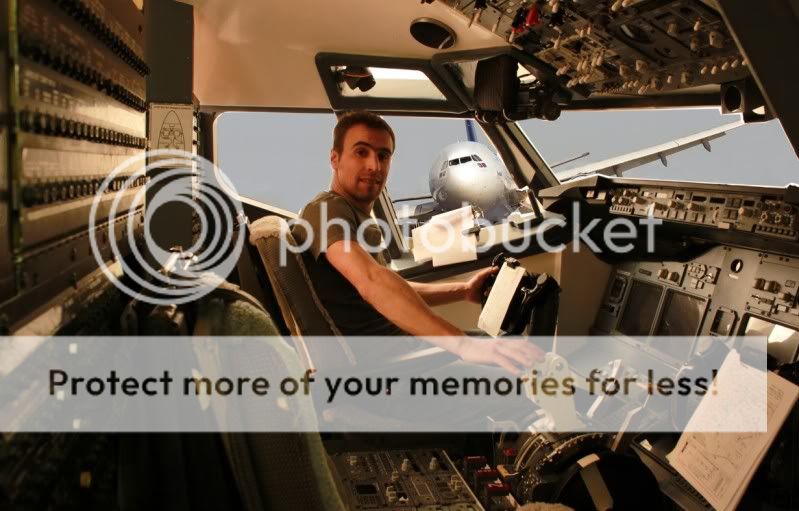

A very few people have seen the picture below, but I have been encouraged to show it to the public, lol.
Have fun :idiot:
Link to bigger picture
http://i31.photobucket.com/albums/c380/vrinsk/ivar.jpg
;D
mpl330
Absolutely fantastic!
Must be an amazing experience
Don't look to your left.... :D
