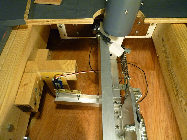

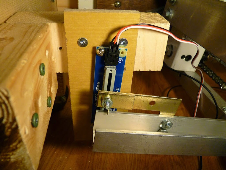

This is how mine works:
60 mm travel sliding potentiometer from Phidgets (same one as Jack mentioned), swinging on one end attached.
Working flawlessly for over 4 years.
See also http://elephantair737.blogspot.ca/p/control-columns.html for more details on my control columns.
:2cw:
