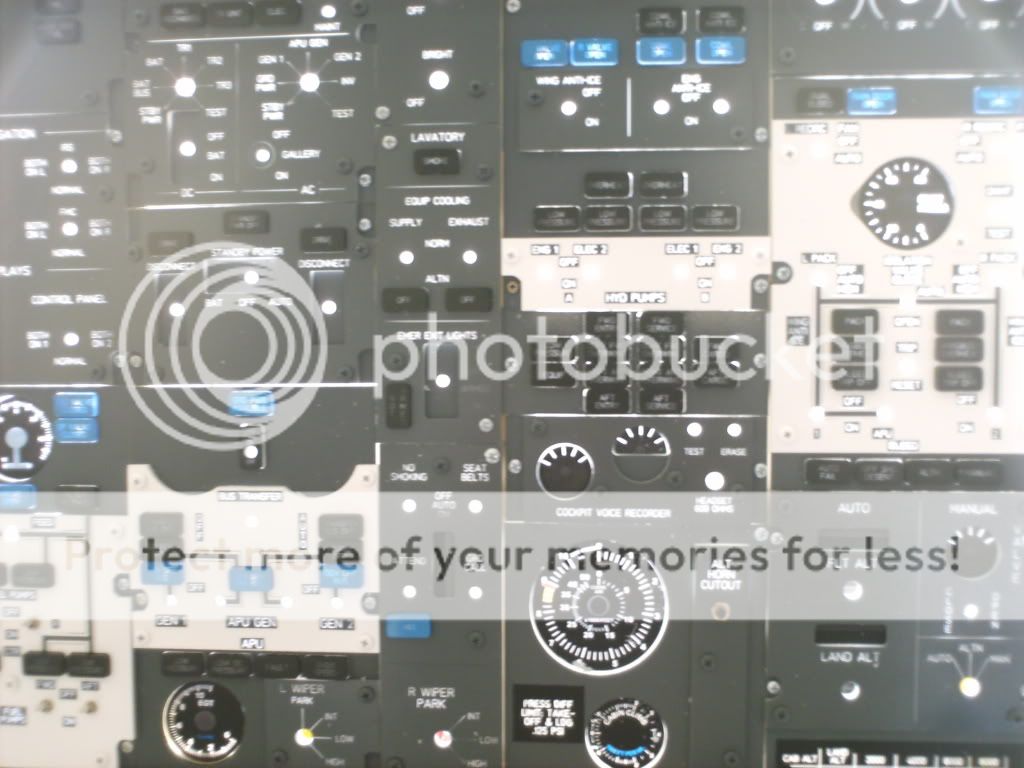

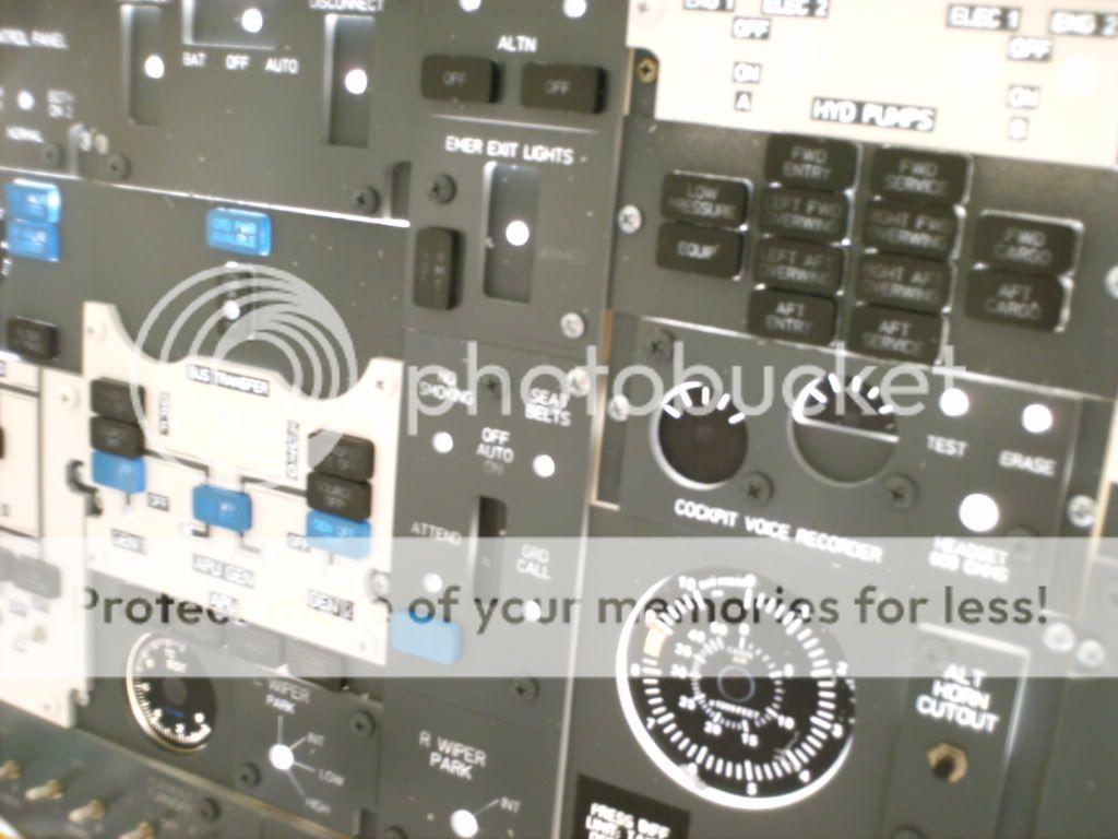

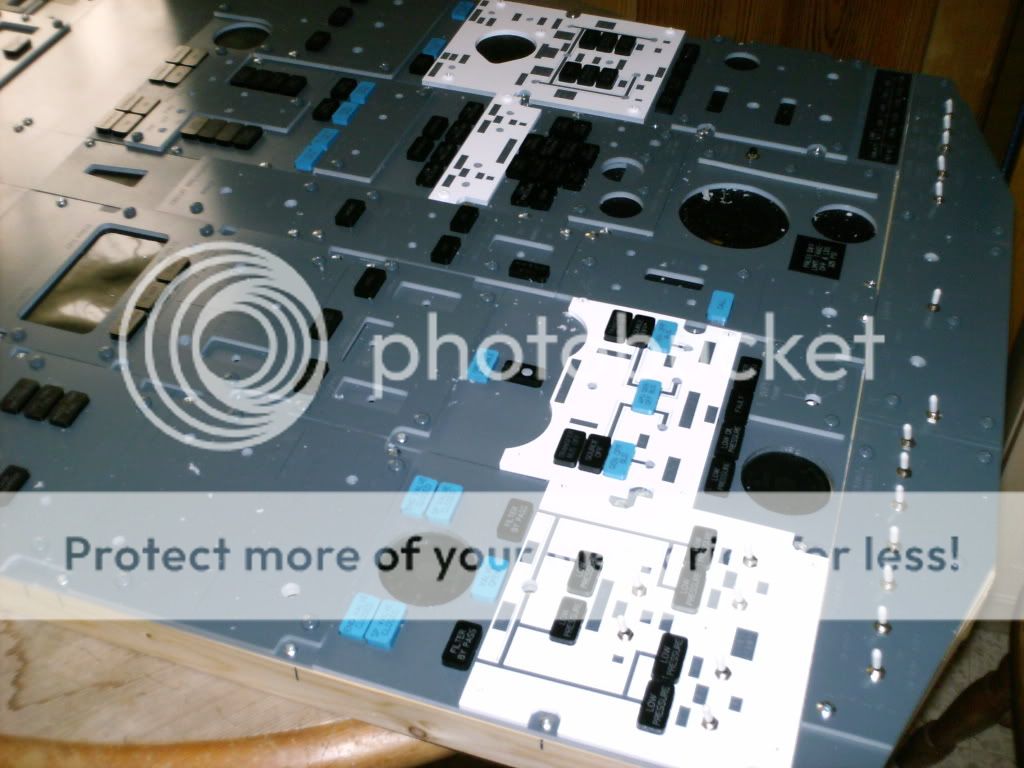

I started wiring up some switches and made the frame base, i have to address some light bleed issues but its looking pretty good, The last couple of shots are with the panel placed in front of my window just to demonstrate how the wonderful backlighting will be.

I modified them to work from the panel lights switch on the overhead and they look cool. Only problem is, above the sim i have all the light escaping, so back to my original question: will i be ok boxing in the top/back off the ovh without causing heat issues.
Steve

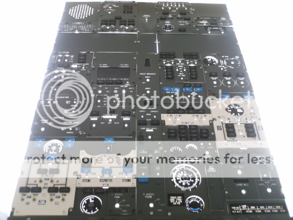

Here are the results with and without annunciators...  :)
