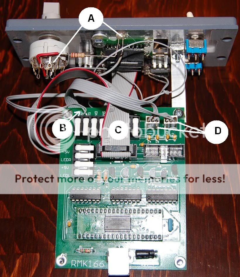

Here is a brief explanation of "my Way" to do it.
Looks much more complicated than it is.
The GF166 board is very easy to figure out and needs no soldering.
You need:
One GF166 remote board
One GF 6 digits display
2 alps encoders (or the GF ones, same)
The rest of the Hardware is either present on the donnor Trx or to be added on any manufacturer's panel.

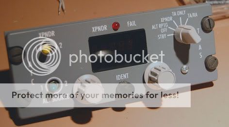

Here we have the FDS one .
TOP SIDE
A:
Wiring the off position of the rotary so that it lights up the Fail led
B:
Wiring a switch terminal of the board to the two tabs of one encoder  ( push function). assigning it to VFR1200 in the GF menu
C:
Ribbon connecting the display to the board. For the Trx only one display is used.
D:

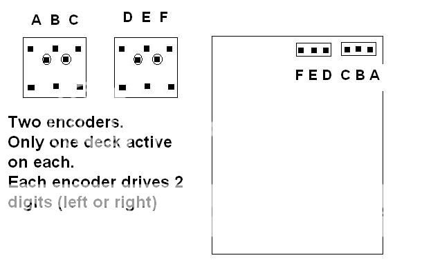

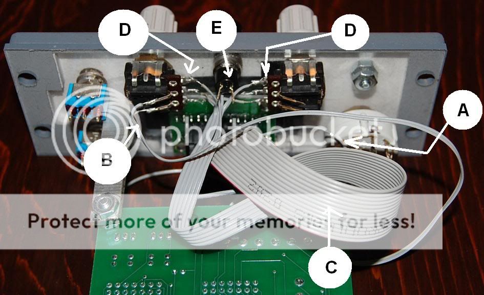

The two Board connectors driven by each encoder (see wiring diag)
BOTTOM SIDE:
same +E which can drive the ident function if the software allows

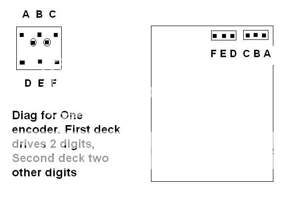

Encoder wiring:
Depending on your transponder, Only One double decker encoder(fairly rare) or two double deckers encoders (here one deck only is used due to limitation of the GF soft, but very easy to use)

Hmm, somthing looks familiar in the last photo ;)
