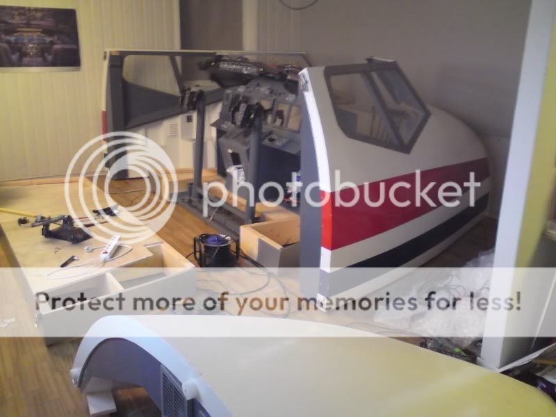

I have not posted any pictures for ages now. But have done some work anyway. So I will make a big post here instead of many small ones ;D

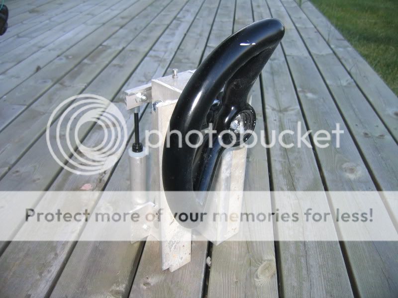

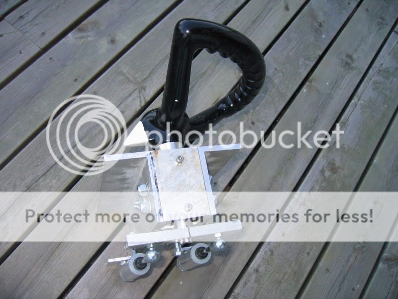

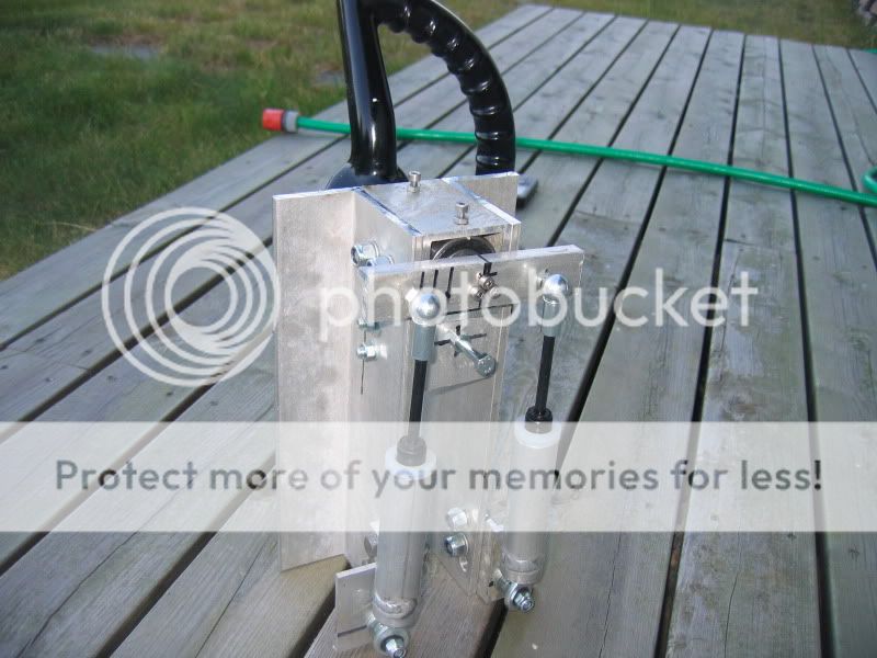

Have spent a few days making the Tiller wheel mechanism, and it turned out pretty good. It does improve the simulator. In the shots the potmeter is missing. But you can see how I did the mechanics here.

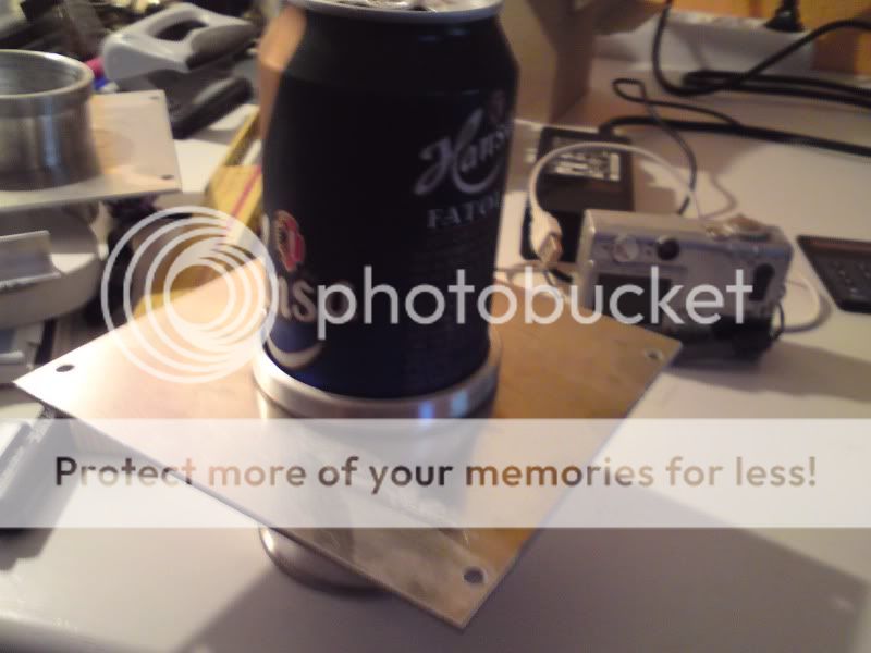

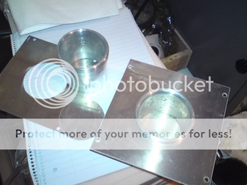

And I have made the cupholders also. One simple autocad drawing. Aluminium cut
in water-jet, then tackwelded together. A beercan fits just perfect. Nice for the weekend flights  ;D

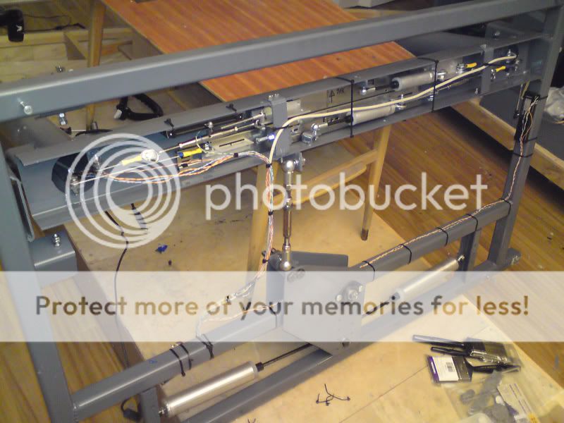

And I also insert a picture of inside my yoke mechanism here. Maybe someone have not seen it.

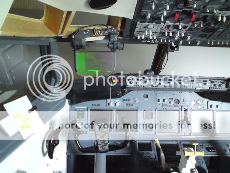

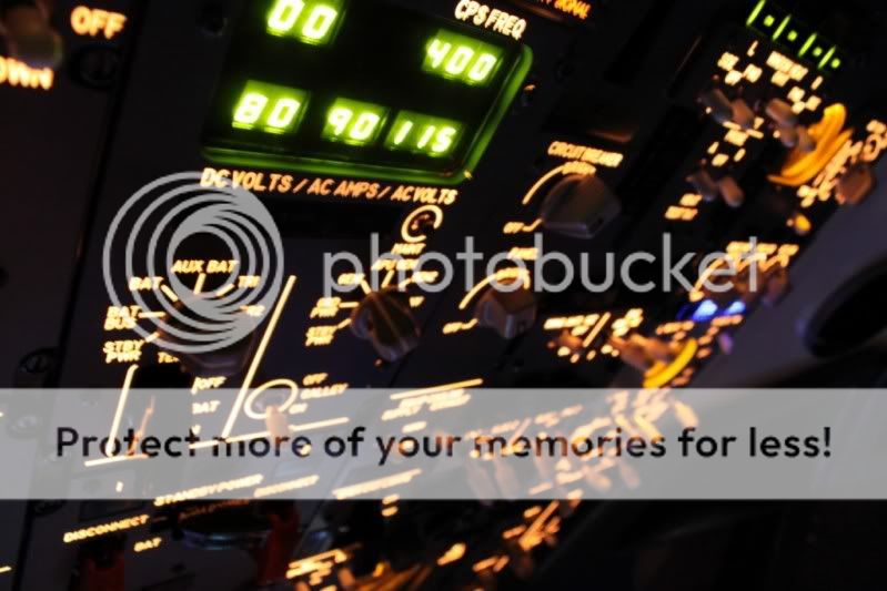

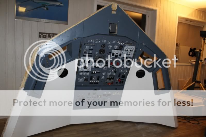

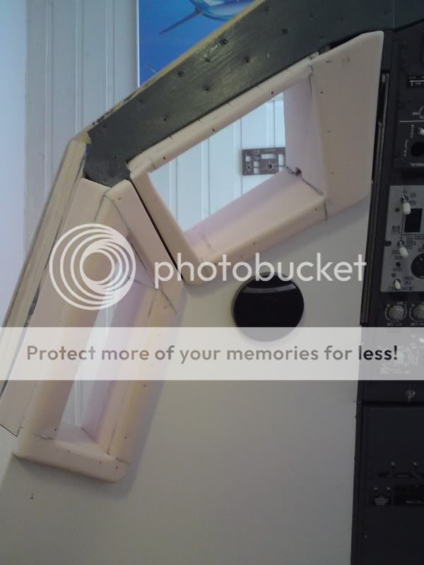

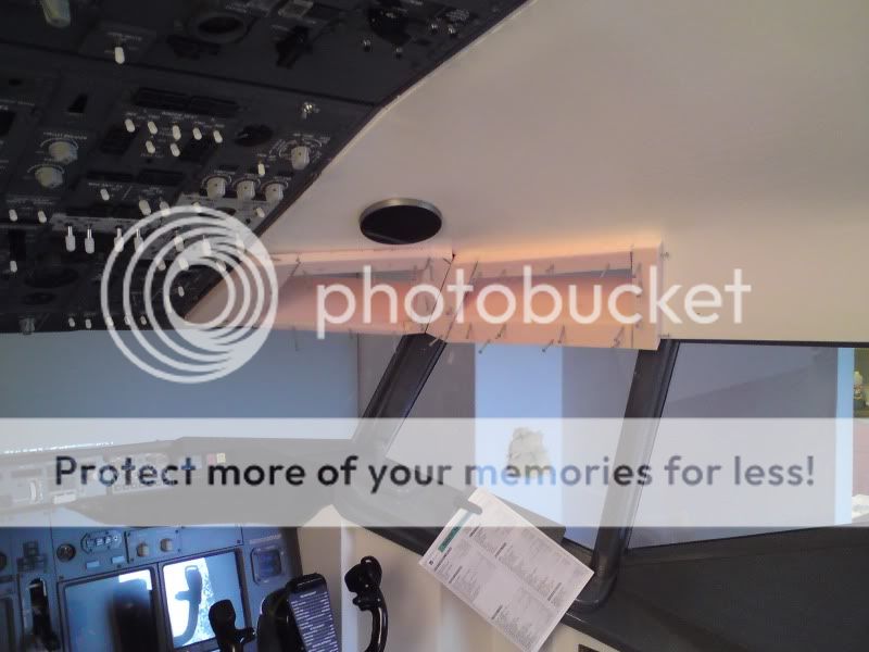

I have also made my eyebrows. They dont look so good really, but I am happy to get the roof covered. Also I won a HUD on ebay, which is a very nice addition to the sim. Hopefully I will get it working at a later stage.
The eyebrows are shaped in a material I dont know the name of. But it is the same stuff that is used in a trucks fibreglass cargo hold.

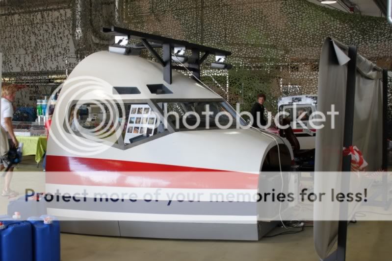

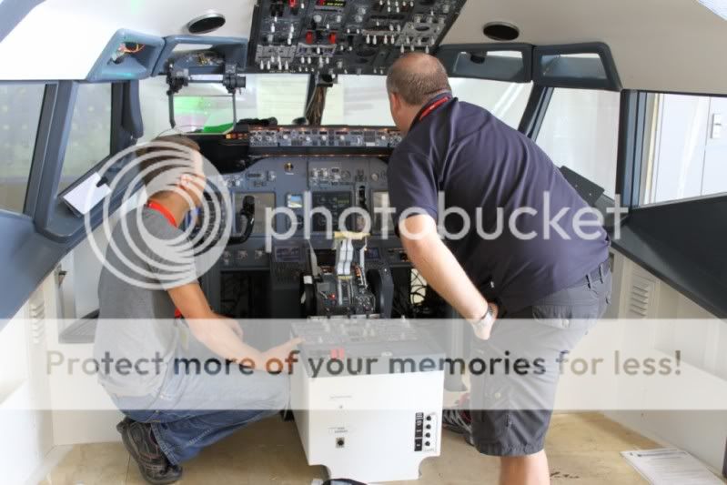

Then I have had a display at Rygge air show 2009. Very nice event and it was fun to be there and talk to all the interested people. Very good feedback to keep the motivation up :)

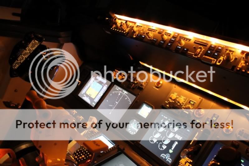

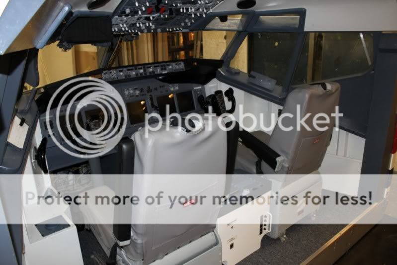

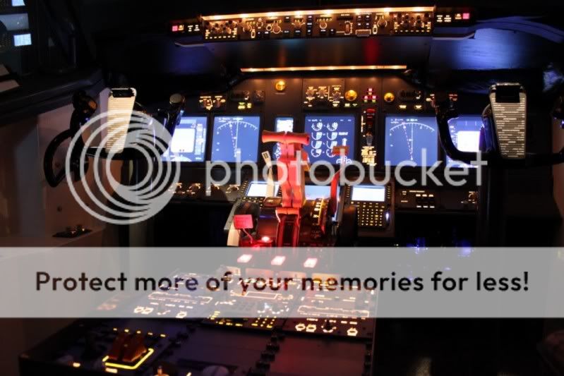

And some shots of the sim in action. As you can see Phil has made a couple of extra panels for my pedestal. Nice work Phil :) Also a picture where I have two seats installed. I have borrowed them from a friend for a few days. Carpet is also in place, so the sim is improving very much. It is a nice ride to fly now :)
I am sorry that I have no update pictures of my ipeco replica seats yet. It is still a work in progress, but take really much time to do. Hopefully some shots later this year :)

PS: what type of Struts/dampers do you use.

Jack, the struts for tiller and elevator are 8kg pressure ones. Fabricate swedish Lesjoforss, but guess any fabricate will do. The feel are nice, but still to light compared to a real yoke/tiller. Most important is that it is nice to fly with at home  :)

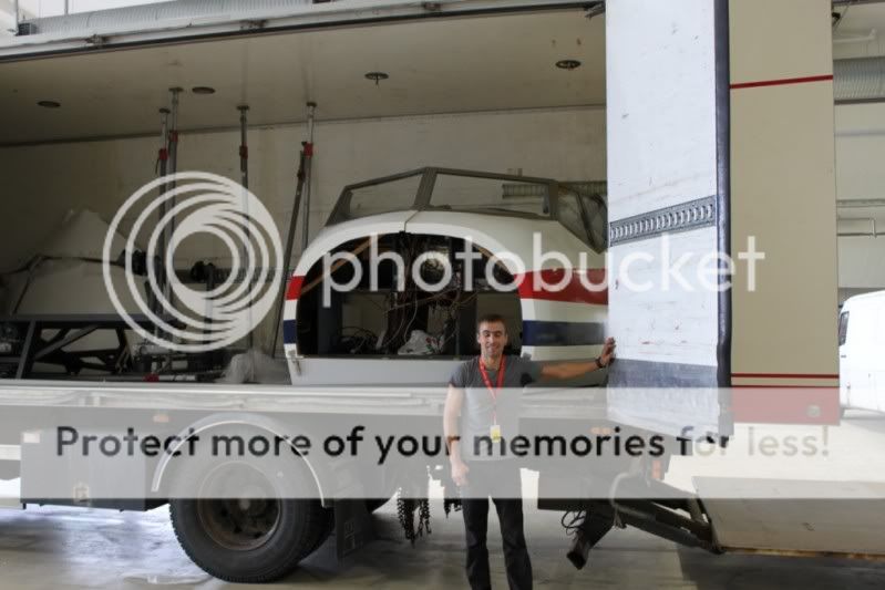

Its one thing to have designed & built such a complex life-like cockpit but to be designed so that it can also be transported in the back of a truck, well, that just blows me away.  The only thing that will move mine is dynamite .....
