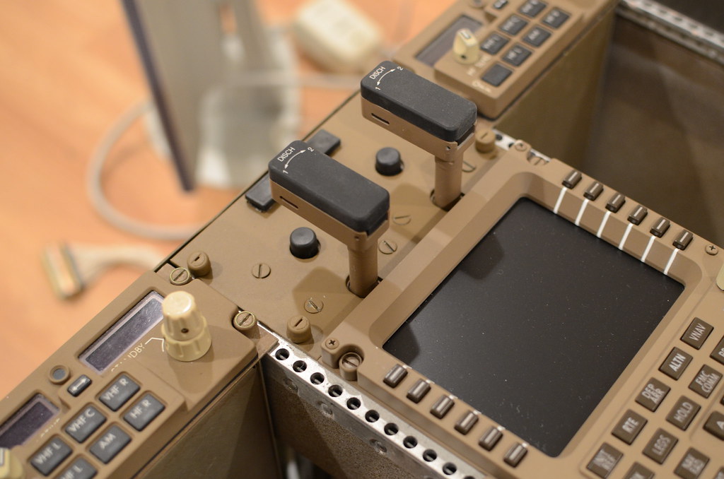

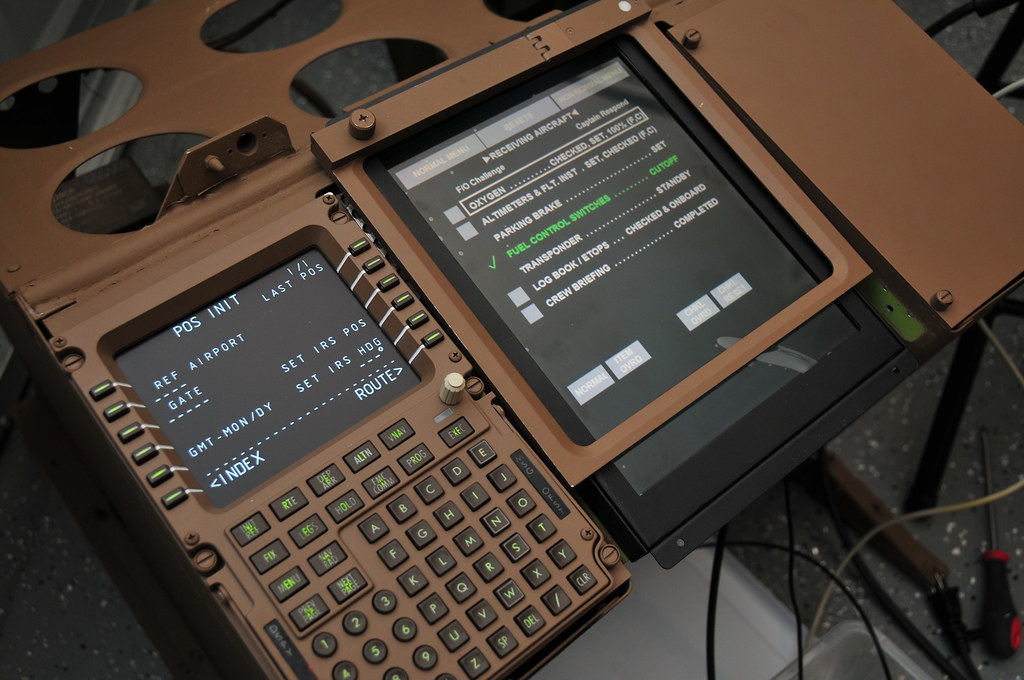

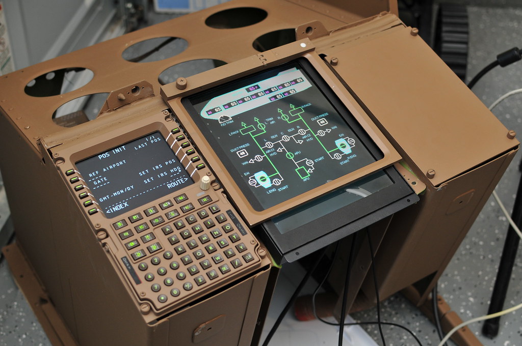

I cut an approximately 1/2 inch notch out of the back wall of the CDU stand in order to allow the CDU screen to fit. Until I made the notch deep enough, the screen bezel prevented the throttle quadrant from sliding into place. Now the screen fits great and the back of the frame has been sanded smooth.
Shown: FDS Pro-MX CDU and Pro MFD 777 Collection Synoptic Displays

That looks fricken sweet! Is that an FDS CDU? Seriously awesome setup. I love me the 757, but I'm a tad jealous looking at your T7! :-)
Looks incredible Robert!   Keep the pics coming.
Love your work Robert, looking really sweet.  How do you find that MFD screen side on?  Is it impaired viewing from the FO side?
Cheers,
rprather
Thanks for the feedback guys! The CDU is indeed from FDS. It fits really well in the original DZUS space. I'll double check the viewing angle of the Lower EICAS LCD now that it is mounted. From the captain's side, the screen was quite legible. If my preliminary experiment is consistent, the screen should be quite easy to read from the FO side as well.

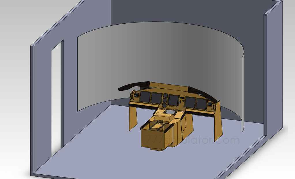

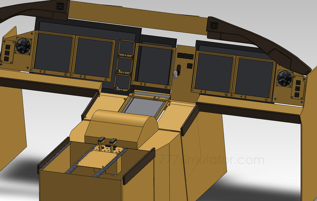

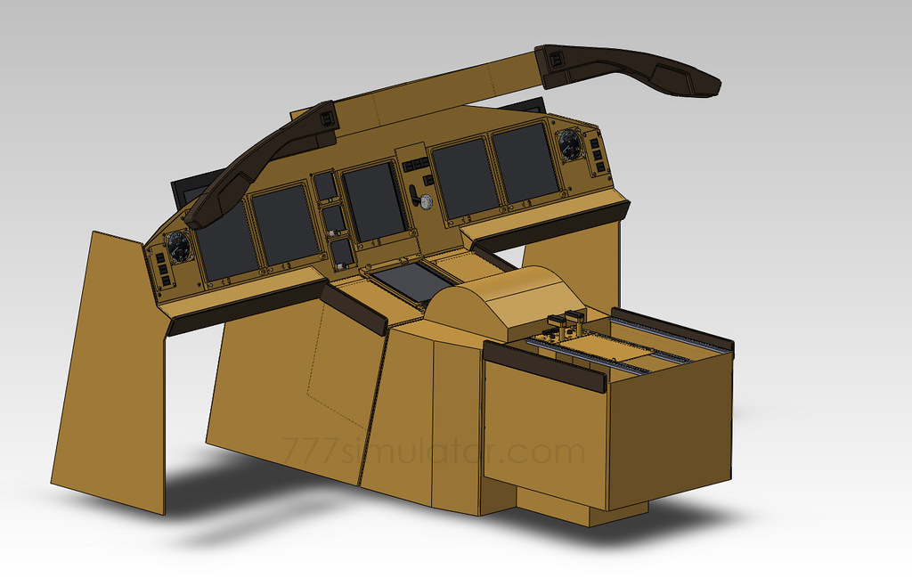

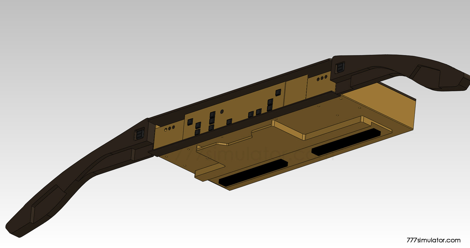

Rendering the 777 flight deck has taken a LOT longer than expected, but has proven necessary to solve various challenges with the MIP design such as glareshield mounting, LCD spacing, lower EICAS monitor clearance and mating with the CDU stand. I rendered the sim room to allow proper planning of the curved screen. That has REALLY helped with calculations such as eyepoint distance, chord line and radius calculations.
My center pedestal is from a 767, so the printer area is not there. Still a LOT of work left to do, but definitely making progress.
Edit: Added exploded view.

Looks great Robert!! Good idea to design that way and get the bugs worked out! Well until the next stage of the project when more bugs creep in :) looks like your on top of it though!
rprather
Thanks Denis and Mike! You're right Mike; Amazing how many glitches pop up in the design phase. I just spotted a few more small spacing issues I need to fix :-)

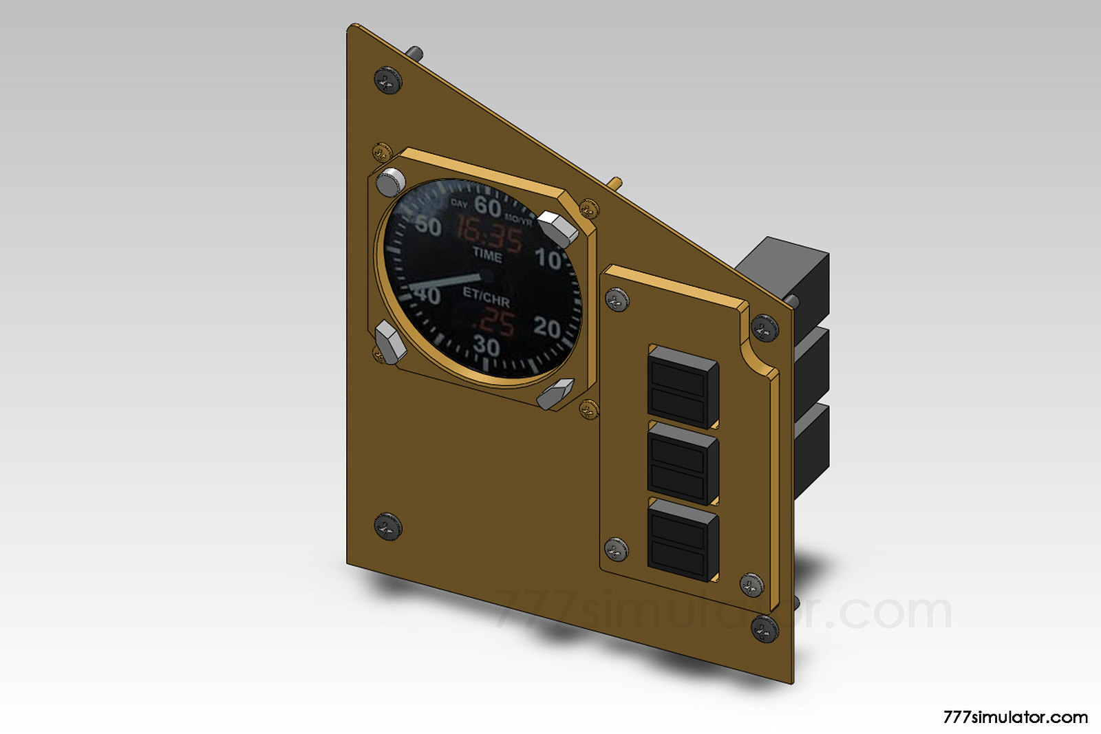

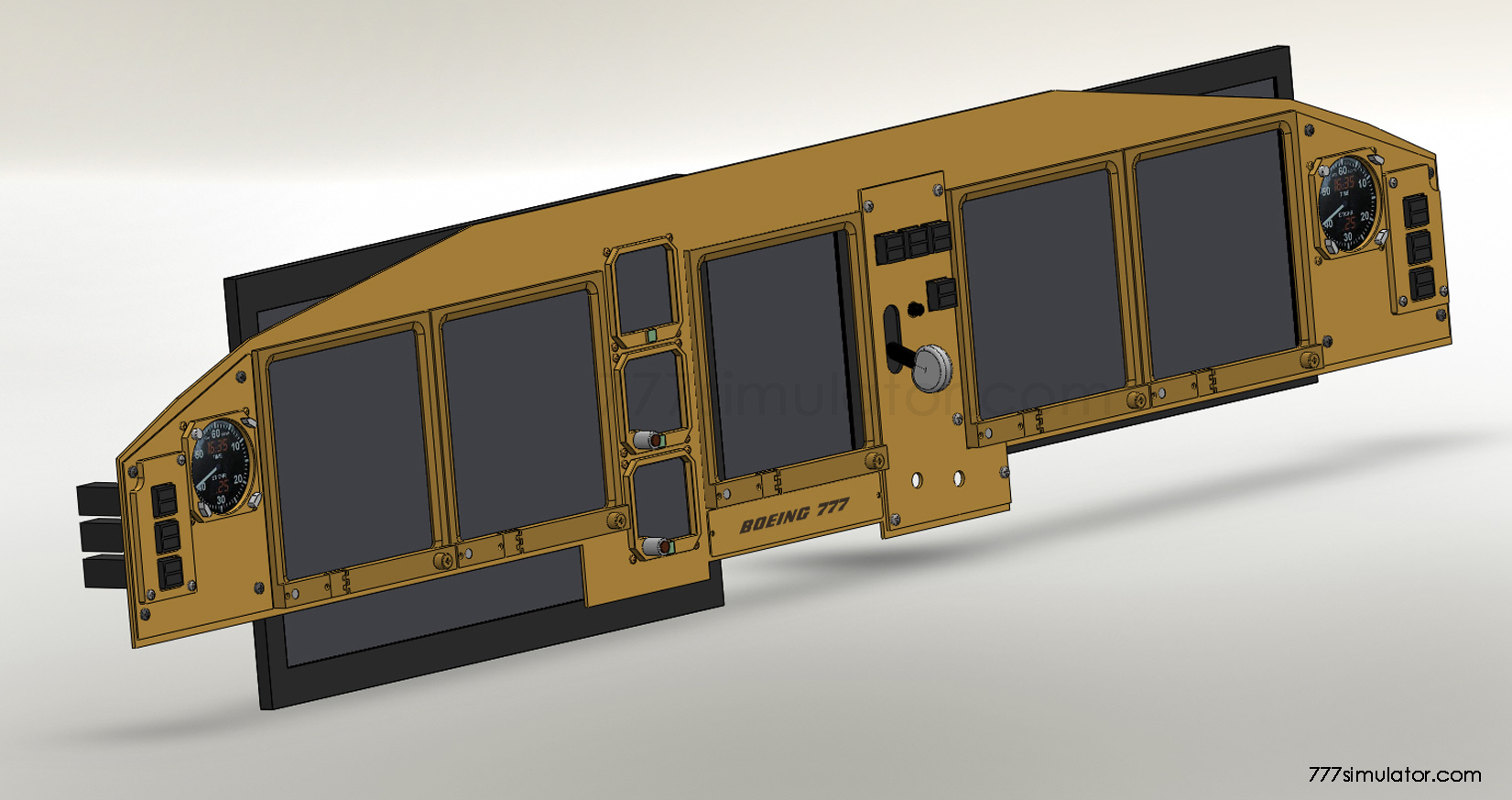

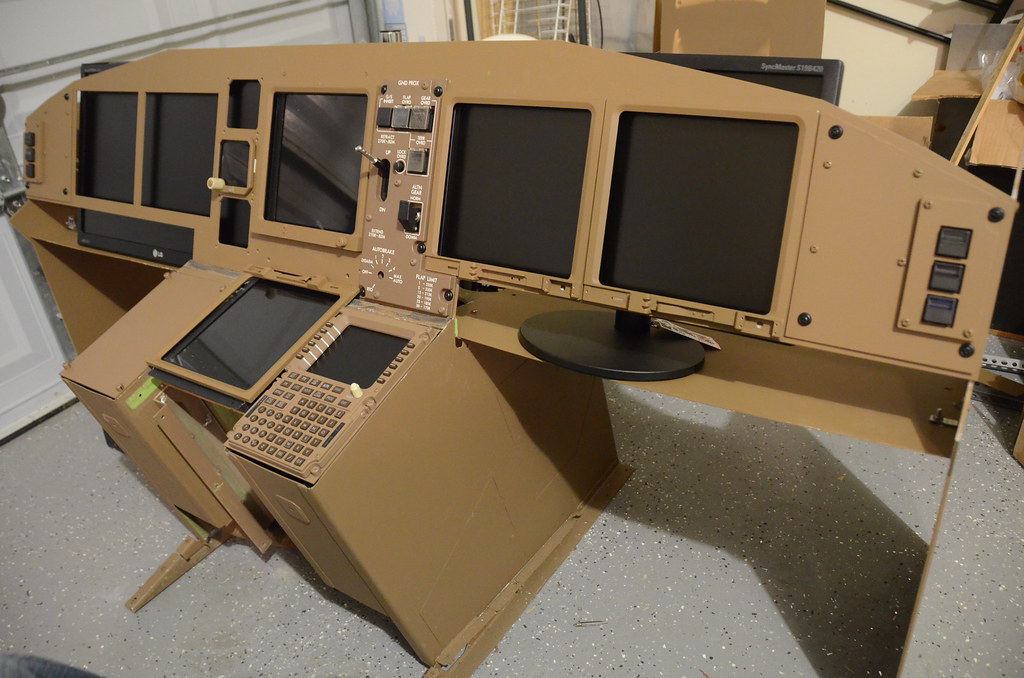

After a year of design work, my instrument panel is finally ready for production! I tip my hat to all the hardware designers for the amount of engineering that goes into making such structures. Getting every screw, gap, mounting bracket, switch and module to line up accurately without interfering with each other has been very challenging.
I also made significant progress on the glareshield rendering. You can see the holes, under the glareshield, that I'm expecting to use for mounting the MCP and EFIS.

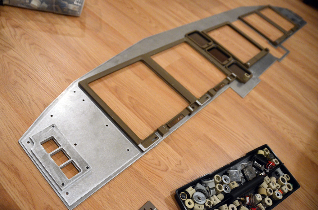

rprather

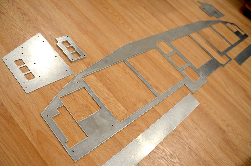

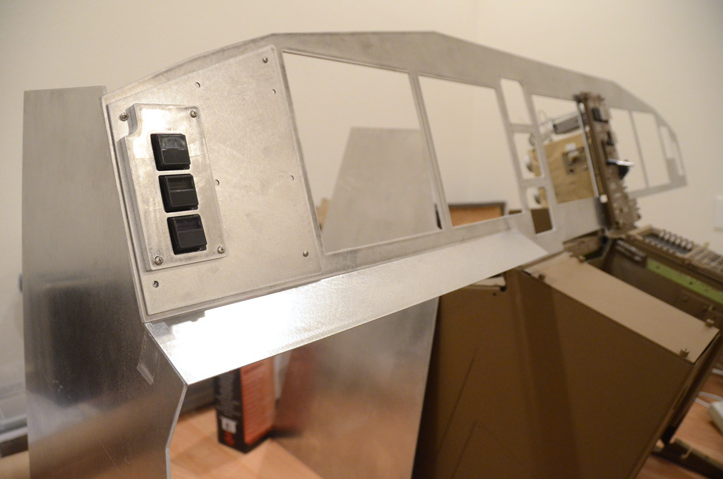

My MIP components have finally been cut and test mounted. I also made metal backplates for a number of my center pedestal components and finished the rendering for the CCD, which I designed to fit the ADI area on the 767 quad.

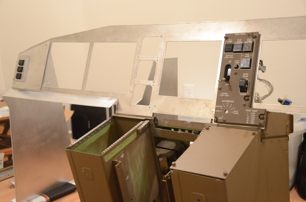

#40
Thank you Warren! Below are my latest updates. Still a lot of detail work to do on the MIP, but it's coming along. Thanks to a lot of guidance from Phil Lambert, Matt Wietlispach and David Allen for tips with cutting/painting. The 767 CDU stand has a lot of small bits that have to be cut off before things fit properly. I'll probably repaint the CDU stand with the new batch of paint (Phil, you were right about using the same paint bucket!).

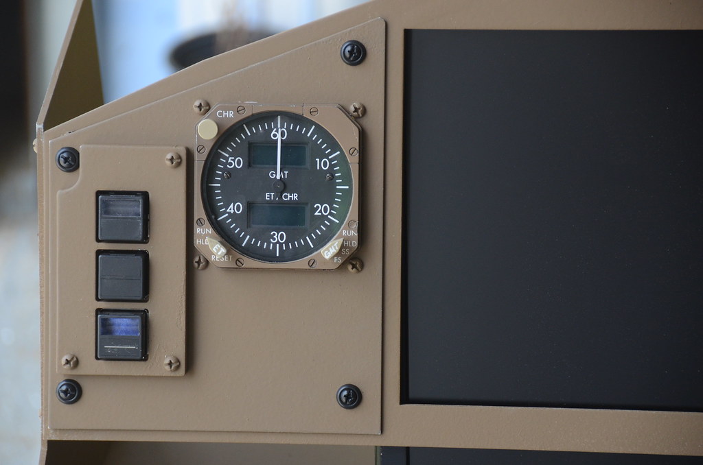

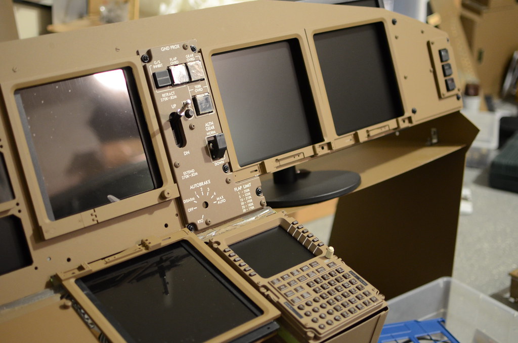

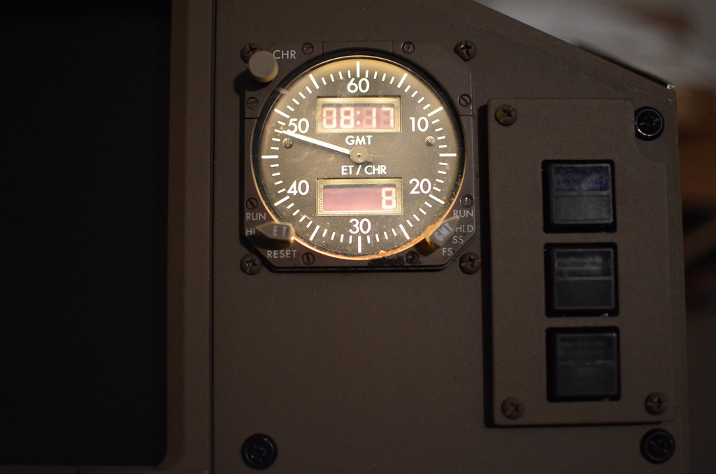

Tested the avionics, clocks and the lightplates. Still lots of alignment to do as well as changing the standby attitude indicator to the right one :-)
Landing gear panel lighting looks completely uniform in person.

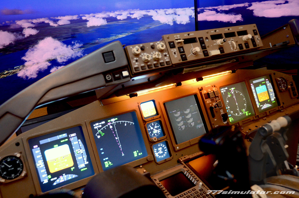

It's hard to believe that in 15 years, I've never simultaneously had a full set of working flight controls, avionics and visuals. So I guess this is officially the "first flight"!! It felt amazing to taxi to the runway, power up and rotate without a keyboard. Especially with the awesome sounds of the new PMDG 777. Obviously, there's still a lot of work to be done, but I'm excited about this milestone.
I had one problem with the 10.4" Pyle screen that I used for the upper and lower EICAS. The three flight instrument screens are connected via TripleHead2Go. The EICAS is mounted vertically and it supports a maximum screen resolution of 800x600. For some reason, any resolution that creates a correct aspect ratio for the pilot and F/O displays, causes the aspect ratio of the EICAS to be too wide (and therefore not take up the whole screen), and vice versa. Instead, I will connect the upper and lower EICAS together (DualHead2Go), then add the CDU to the TripleHead2Go.
Custom made glareshield using a mixture of carbon steel, aluminum and wood
Auto-throttle module from Edoardo's team. Excellent piece of engineering!
More photos on Flickr page. See link in signature.

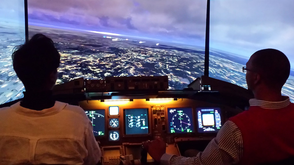

Below are a few more recent pics of the sim. Landing at KIAH with REX weather.
