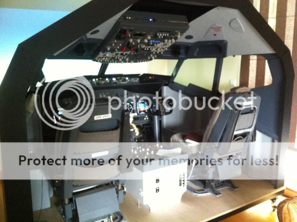

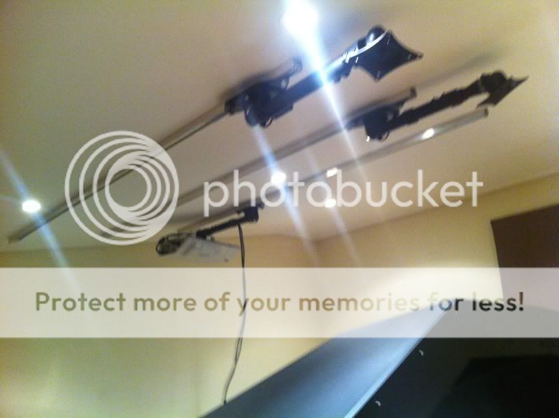

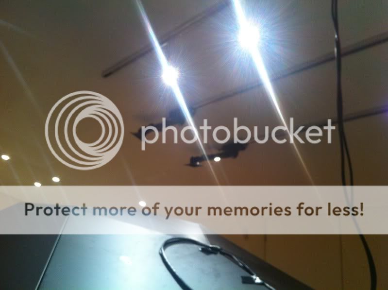

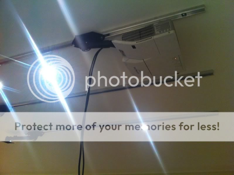

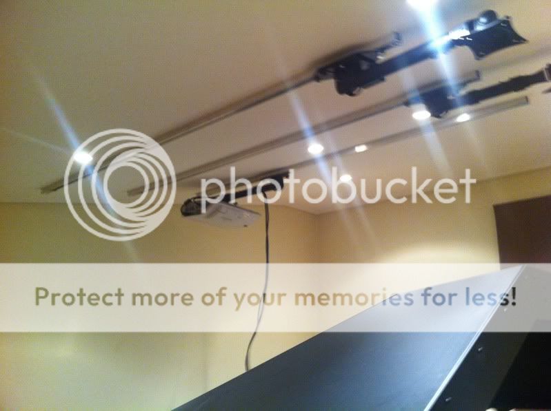

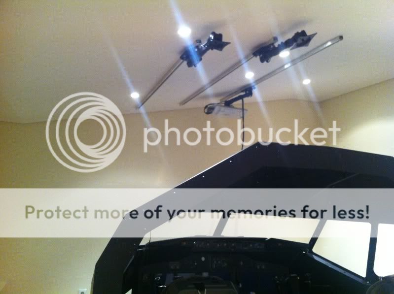

So, as you see in the pictures below, I have built and installed a three rail independent projector system above my shell, which can move its projector back, forth, left, right, up, down and swivel 360 degrees. My main issue is that my roof is pitched so I had to discover the way to fix this problem. This means that when the times comes and the projectors are in place I can make any micro-movements to it's projector and hopefully have a good result at the end of the day. Just for your info the rails come from IKEA curtain rails sold everywhere in the world.
The pics...
So given that I can adjust the throwing distance from 0.5 meters to 2.0 meters which is the best projector solution you advise me to go to ?
I am thinking of course to go to the usual route of curved screen possibly by plasterboards or fabric with bangees as many have followed here, so any advice will be highly appreciated...
Thank you in advance,

Nice set-up to easily adjust the projectors.  I'm hoping that the tracks are attached to a ceiling that isn't a floor above that someone can walk on.

No the ceiling is the the ceiling of the top floor of my house and that's why it is pitched. The room that my sim is situated is the loft of the house, so there is no issue in this.

Nice...real nice...now a mental note for Nick's overworked brain. Put a fan somewhere up there to blow the heat down and away. All the heat of your sim, your booty and your projectors will have no where too go otherwise. That means shortened life span for your bulbs and projectors...
Trust my brain sending your brain that message, as well as that I've been there done that and got the "Nude Sim Flying Only-due to overheating" T-shirt...lol.  :idiot:

These projectors mounts seem like very fancy & expensive ones. What brand are they or are they the ones made to fit a particular brand of projectors?
