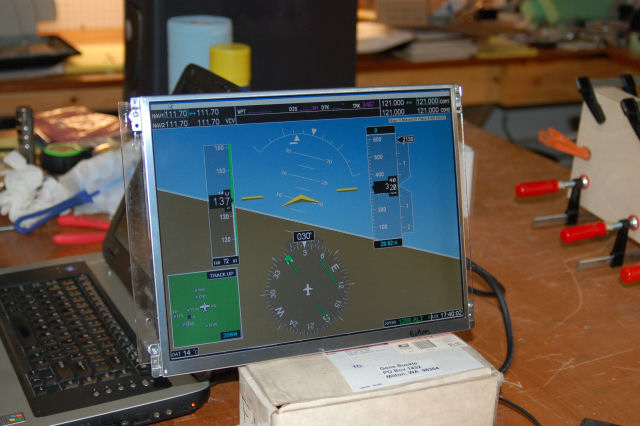

That's the idea anyway.  It'll be a single screen version that runs in Reversionary mode all the time because I don't have the space for both the PFD and the MFD.
A friend of mine in the UK is working on a 100% G1000 emulator that will work with XPlane, MSFS and probably FlightGear.
Here's a pic of an early pre-OpenGL version:
The instrument panel I've made has room for the button bar along the bottom as well as the control panels to either side.  I may end up combining the buttons from other panels to make what I need fit on the space I have available.

Looks very realistic so far Gene.   I have been waiting for Flight1tech to put out the G1000 Student edition.  Maybe your friend will beat them to it :-)  In any event, it will be a must have for the new GA pilot to have.
