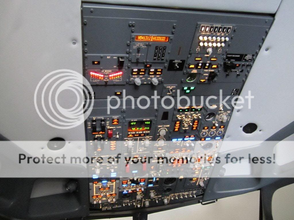

The ICS plug and play AFT overhead. All annunciators, switches and displays are functional. Gauge has to be fitted. IRS display and keypad are functional.

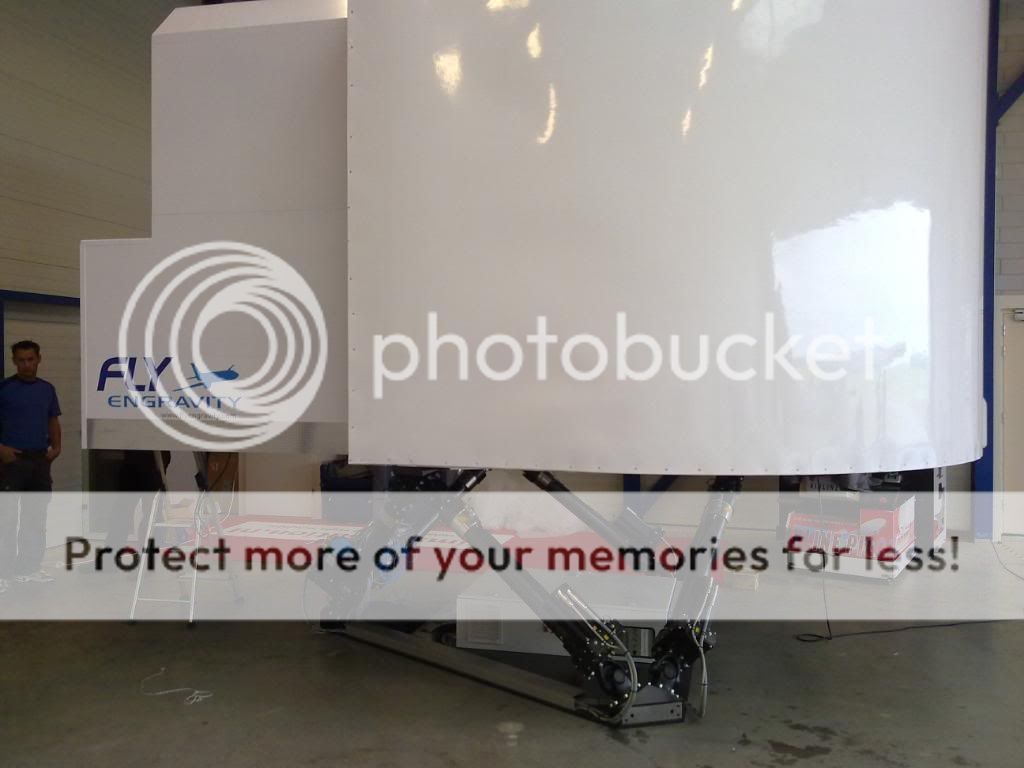

Our facilities. The sim is about as high as the overhead door when the platform is TOTALLY lowered to its lowest position.
There she goes.
A tight fit !
Lifting the sim with a crane to be put on a special transport.
Transport is being taken care of by Royal SAAN, a dutch company specialized in aircraft transportation and salvage.
The final location. A hangar on Lelystad Airport in the netherlands.
