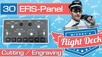

The first cockpit task for my CNC router. I'm making an EFIS panel.
https://www.youtube.com/watch?v=Nv1c_u2vaQ4
Hey Michael,
I am so glad to see you covering the CNC and your way of explaining everything is the best ever. My plan is too turn mine on again and start learning more about it. With learning 3D printing for so long I haven't given much thought about my CNC, but you've inspired me...
Please keep the videos coming!

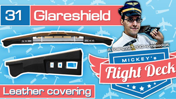

The glareshield is covered with leather and I have installed my first LED lighting.
https://www.youtube.com/watch?v=SaoQsejS4iY
