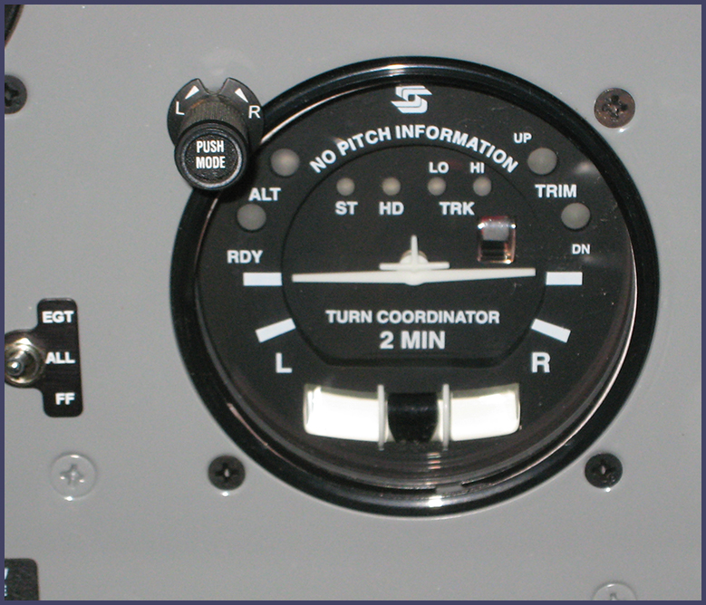

This weekend I have made the hardware and electronics of the Stec-30 autopilot V2.0 (the release candidate 🙃) for my A2A comanche home cockpit. The main switch has a buzzer (for "beep" "beep" changing mode). The push buttons will be in the yoke (AP desconnect and ALT hold). Now de led indicators are all dimmable, to fly night or day.
It was very dificult to find a potentiometer with a push button for mode change (I only find two in the world, I bought them, and the feeling was really bad). So I have made one that works perfect! with a pot and a push button, with the help of my dear 3d printer.
Now I have to fix some programming, but it will work more or less the same like v1.0 version. Here is a vid of it:

iwik
Arturo,
A very nice job. Do you do the housing and guts all yourself because it really looks like an
OEM one.
Les
_alioth_
Quote from: iwik on December 10, 2018, 02:24:28 PM
Arturo,
OEM one.
Les
Thanks.
The original gauge is a turn coordinator from an old AST300 simulator. It was only a turn coordinator instrument, that was made with a real turn coordinator gauge replacing the ball system with a big galvanometer. The turn rate and ball are galvanometers, which I already interfaced with prepar3d.
So, I drilled the plate and put the led indicators,  made the new text in the upper side, electronics, arduino, etc,.  to emulate a real Stec30, like this one:
It is not perfect, but I am quite happy with the result. I should try to find a better knob..
My whole cockpit is being made with real gauges with some mods.
Arturo.
